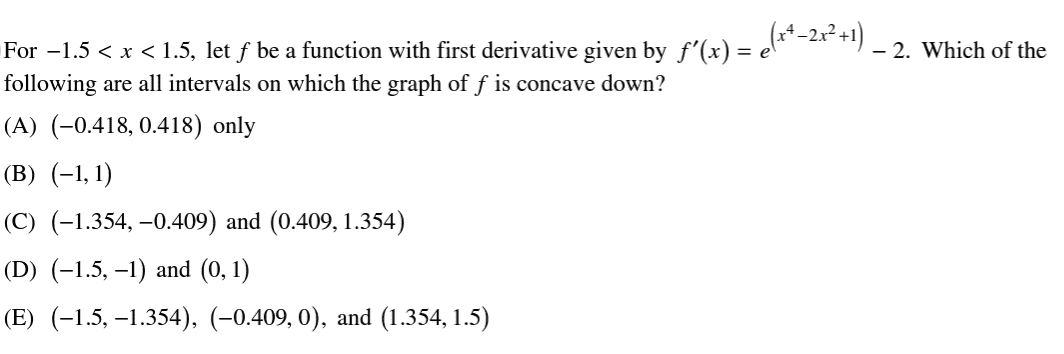

screen shot to avoid typos
OK the key said it was D
I surfed for about half hour trying to find a solution to this but $f'(0)$ doesn't equal any of these numbers
$e^0=\pm 1$ from the $e^{(x^2-1)^2}$
kinda ?
this is a calculator active problem.
graph f’(x) in the given interval and look for the intervals where the slope of f’(x) = f’’(x) < 0
$(-1.5,-1) \cup (0,1)$
[DESMOS]{"version":7,"graph":{"viewport":{"xmin":-3,"ymin":-12.12442693138332,"xmax":3,"ymax":12.12442693138332}},"randomSeed":"f9c61ea916ed9ae4b364c88ac8d063a8","expressions":{"list":[{"type":"expression","id":"1","color":"#c74440","latex":"y=\\exp\\left(\\left(x^{2}-1\\right)^{2}\\right)-2"}]}}[/DESMOS]
this can also be done algebraically ...
$f’’(x) = e^{(x^2-1)^2} \cdot 4x(x^2-1)$
$f’’(x) =0$ at $x=0$ and $x= \pm 1$
from here one can determine the sign of f’’(x) in the four intervals bounded by the zeros

Why should it be? Saying that the graph is ''concave down" means that the second derivative is negative and that changes where the second derivative, not the first, is 0.
