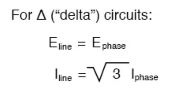

I was referring to Delta circuit.
So if
line A & B = 10 amperes
line B & C = 10 amperes
line C & A = 10 amperes
These are phase currents as Baluncore sugguested So since the line current = 1.73 x 10 A or about 17.3 A.
Then the actual wire amperage capacity of each of the wire in the Delta must match the 17.3A and not 10A. Is this right?? (this is the primary question)
"In the delta" is not the same as the feeders that go from source to load. The delta connected transformers you show will have a 10 amp load each. Only after they are connected together and the conductors become feeders en route to the load will they carry 17.33 amps.

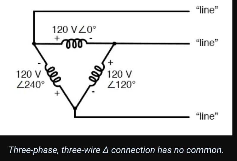

Ok, yeah, I didn't realize they would express a "line" amperage...but yeah, not the same as the phase wire's amps. I'm actually not clear why that would be useful and can see why it might be confusing.
...it also implies the diagram is mislabeled?
[Edit]Oh, I see, no, the line current still just is what it is, but the phase current is measured in the delta.

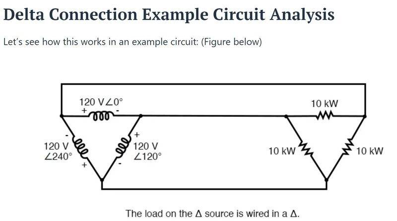

https://www.allaboutcircuits.com/textbook/alternating-current/chpt-10/three-phase-y-delta-configurations/
I can see this causing confusion because I was thinking externally the three wires could be called a "line" or "phase" interchangably.
The nomenclature is a mess, but there's no authority empowered to clean it up.
Likes russ_watters
Where I come from a 'phase' is always a pair of wires. A 'leg' is a single wire. This wire can be a single lead off a transformer in wye configuration or the node that two separate transformers connect together at on delta configuration. But never the neutral.
I believe it is common to refer to a hot and neutral pair in wye as a phase also. Not sure if it's technically correct. I've also heard an individual hot called a phase wire. This I assume electricians will refer to in order to differentiate between a hot and neutral when running through a conduit or similar raceway. I just refer to it as hot. 120/208 wye may have almost 100% 120 volt loads so it would be common to run one hot and the neutral in conduits.
Let's say your electric dryer requires 230 volts, from P = V I, Let's say the power is 2300 Watts so the ampere is 10 A in our example.
So Line A & B = 10 Amperes
These are phase currents. What seems odd to me is the 10 Amperes will only run inside the power company Delta circuit. While what comes out will be 17.33 A??
If so, won't the electric dryer becomes 17.33A? Then what would change here:
P = 2300 Watts
V = 230 Volts
I = 10 Am??

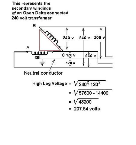

I found out the transformer of the commercial building I'm leasing uses Open Delta. So if the load is 10A. Would it draw 17.33A from the lines or 10A?? How do you apply your Wye reasoning to this case? The same 17.33A for all cases??
Ok @Awwtumn I'm going to sound a little edgy because it seems to be my nature but I'm going to try to stay in control. Nothing personal.
If you read my post about a wye source driving a balanced delta load, how can you not understand it? Always go back to watts if you are having trouble. Three loads dissipating 2080 watts have to source that power from three transformers. The power can come from NOWHERE ELSE! The math says this. Do the math, it shows 17.33 amps. Now if you drive with a delta source it makes no difference in the feeder conductors. They will still have to carry 17.33.
Likes Awwtumn
