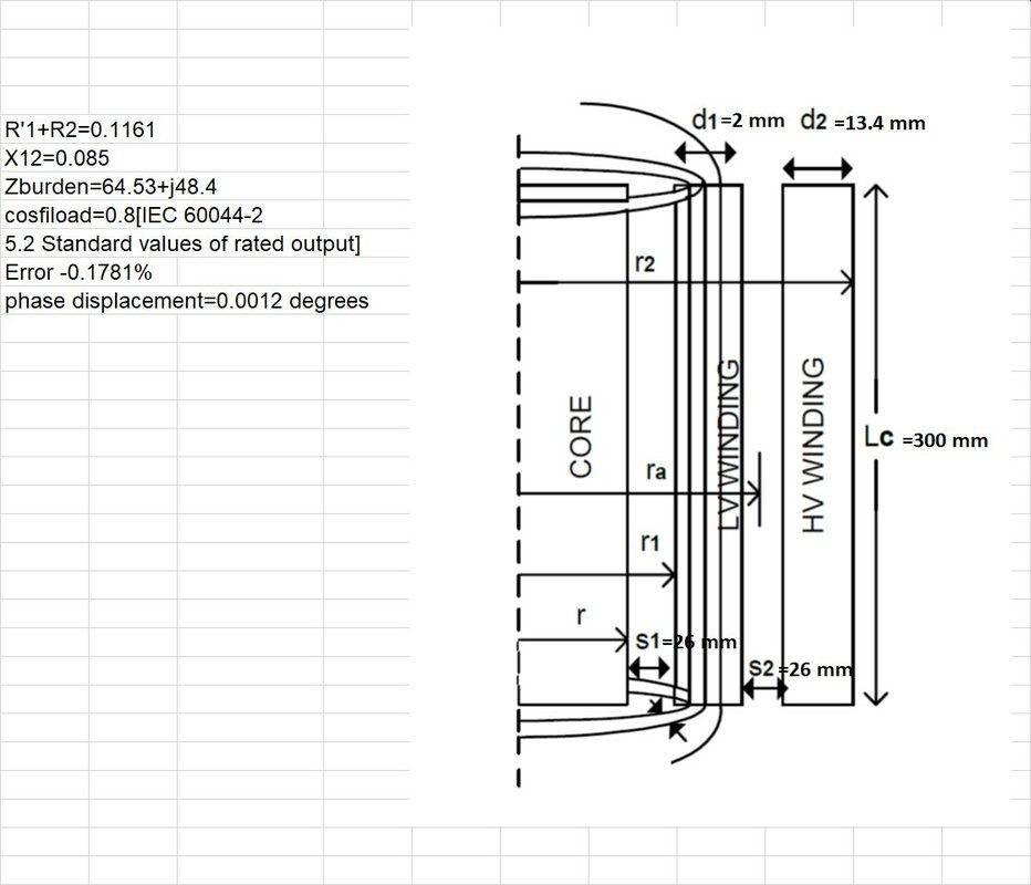

I hope there is not any miscalculation
I considered 1.2 A/cm for 0.85 Wb/m^2 and 1.171 W/kg [1.35 W/kg for 1 Wb/m^2 x1.2 suppl.losses ]
I didn't got what this pic shows can u please explain?
Let's do a little order in your information.
First it seems the actual voltages are 33/√3=19.053 kV and 110/√3=63.5 V
Let's say 5000 mm^2 it is gross. A 1.07 factor can be used then net iron it is Sfe=5000/1.07
let's say the magnetic core is square then the width and the depth are √(5000)=70.7 mm. The minimum turn diameter is dia= √2x70.7=100 mm
The minimum turn length=π.dia=315 mm the minimum length of 18000 turns=18000*315=5670 m.
If the HV and LV bobbins are concentric and the LV it is close to core [ 5 mm insulation width 3 mm LV bobbin width and 6 mm HV].
The HV bobbin is separated from LV bobbin by a 20 mm thick insulation cylinder
LV turn length=π.(dia+2x5+3)=355 mm[total length=21.36 m] and HV turn length=542.5 mm[total length=18000*542.5=9765 m
Then the LV resistance at 20oC will be: 21.36/58/3.2429=0.113 ohm and HV 9765/58/0.0293=5746.1 ohm [for SWG14 and 36]
Limb [core column length 250 mm and core yoke 156 mm.
I considered 1.2 A/cm for 0.85 Wb/m^2 and 1.171 W/kg [1.35 W/kg for 1 Wb/m^2 x1.2 suppl.losses]
In this case the voltage error was -0.405
I proposed SWG10 and 30 and at first glance I got even less than 0.2.
Using a new [ more accurate] calculation I got only 0.26 indeed.
