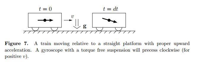

Consider the thought experiment in the diagram below.
According to the authors, the vector will rotate even in the rest frame of the moving train relative to the body of the train. Is it possible to consider the spin axis of the gyroscope represented by the vector as a simple rod and analyse the situation as a simple 4-acceleration problem? If, so would the rod rotate by exactly the same amount in the rest frame of the train, irrespective of its original orientation? I suspect there is a critical orientation of the rod that would be exactly parallel to the boosted acceleration, such that no rotation of the rod occurs. If so, this would suggest that an initial assembly of rods that are orthogonal to each other would not remain orthogonal, because they rotate at different rates.
The above diagram comes from this paper http://www.relativitet.se/Webarticles/2006CQG-Jonsson23p37.pdf which is specifically about gyroscopes. Would we expect rods and gyroscopes to rotate differently is no torque is directly applied to them? One issue that is mentioned in the paper is that in certain reference frames, the proper centre of mass is no longer at the normal centre of mass of a perfectly balanced gyroscope. This might be a source of torque even when we think we are applying the acceleration to the centre of mass of the gyroscope in a torque free way.

However I don't see the need to consider the spin axis of the gyroscope as a rod. Why not just keep it as a spin 4-vector space-like relative to the gyroscope as usual? Why represent it as a rod? The mathematical analysis only requires us to represent the gyroscope's spin axis as a spin vector.

Well you certainly don't need the whole formalism of Fermi-transport and spin 4-vectors for this problem. The second paper for example tackles the problem very elegantly (especially from a physics standpoint) using elementary calculations so if what you're really after is an elementary analysis of the gyroscopic precession in the train frame then the second paper does a fine job of providing just that. But notice that a key ingredient of the calculations is the relationship between the differential change in angle and differential change in boost velocity; since the only 4-acceleration in this problem is that of the platform, you cannot use only 4-acceleration to analyze the problem as you will not be able to employ said key ingredient.

You can't leave the gyroscope out completely because a key assumption of the problem is that the "gyroscope" vector is Fermi-Walker transported. If you just make it a "rod", then what ensures, physically, that it is Fermi-Walker transported? There has to be *some* mechanism, physically, that does that; a gyroscope is just a convenient mechanism.

The introduction of the rod really won't change the analysis at all so you may as well stick to talking about the spin axis of the gyroscope. Anyways, no the initial orientation would not affect the precession-think back to the picture of the platform in its curved parabolic shape moving backwards relative to the train rest frame mentioned in post #2.

The precession of the spin axis is given in terms of the cross product of the train velocity relative to the platform and the upwards platform acceleration. The only way to have the precession vanish is to consider the trivial case of the train having a velocity parallel to the platform acceleration. Apart from that, no orientation of the spin axis can prevent it from precessing in the train rest frame.
I'm not quite sure what the question is, but there isn't any difference between a force-free rod with no angular momentum and a gyroscope. However, not all rods are force-free, and not all rods have zero angular momentum. A force free gyroscope is less ambiguous.
To expand on this a bit, if the train is rotating, and the gyroscope isn't, something is exerting a torque on the train to make it rotate. If the train was accelerated in a torque free manner through it's center of mass without touching the floor, it would rotate relative to the floor just like the gyroscope does.
