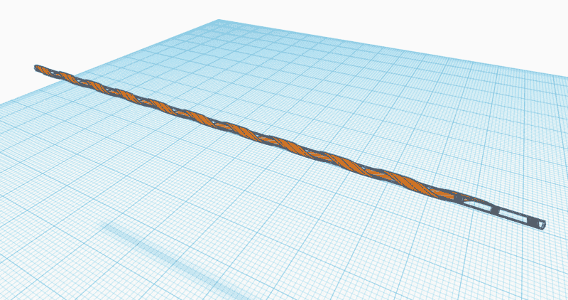

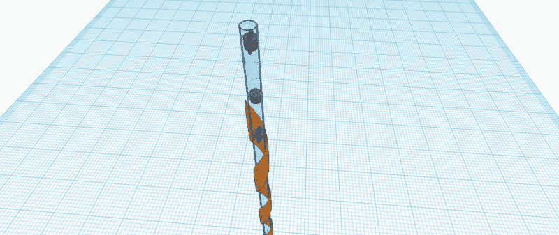

I suppose I have one follow up question. Is there any information, or any 'law' that I can look up that deals with the relationship between the strength of the Eddy currents as it relates to the mass of the conductive metal?
If instead of an aluminum object, or ball, what if...aluminum flakes or pellets fall down the magnetic tube?
The only thing I've learned from YouTube videos is that the distance from the object's outer edges to the inner walls of the tube have a significant effect on the strength of Eddy currents generated, thus, the speed at which is descends down the tube. It seems like the smaller the conductive object is, the less magnetic field it would induce. I guess I could always think about making a smaller diameter magnet tube?
Sorry, lots of questions on my mind!

If you are trying to avoid the Lenz Force - you might want to try 304 or 316 stainless steel tubes instead of copper. Austentic Stainless Steel is both non-magnetic and non-conductive - at least on paper. You may need to heat treat the SS to 2950 F if you did any threading, bending or cutting - since these cold-work processes magnetize the steel. Heat treatments will again de-magnetize them.
Non-conductive? Can you post a link to a source about that? Is it because of some coating or something?
Likes hutchphd
But, short of purchasing large tubes of carbon fiber, or titanium alloy - 316 stainless steel is probably your best choice. I am using it to build Tubular Linear Induction Motors for my project.
