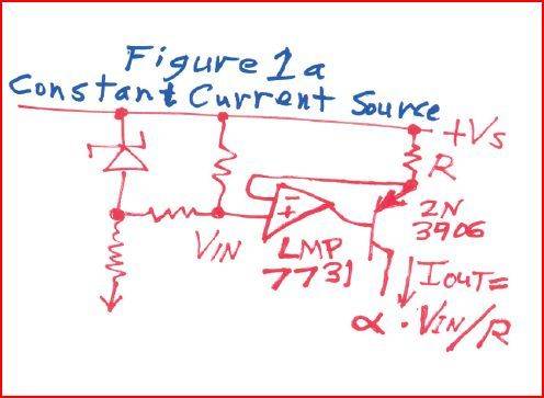

Hi
Please c the following circuit. how can I decide the specifications of the opamp?
I will be choosing a BC 328-40 pnp transistor for the output stage. It will be bale to take a maximum collector current of 800mA, a little more than my requirement. the input to the opamp is through a Zener.
Will the zener essentially be doing in this circuit? how do i calculate the resistances at the input terminal?
Please help me. I tried to replace the previous circuit with this now to source more current.
Thank You
Kari

Why is there an alpha in your Iout equation?
that was how the circuit was described. it means the transistor parameters change teh load current rt? would that be a bad design?
The opamp is there to take out the variabilities of the transistor's parameters. The only thing you need to worry about is that the transistor can handle the heat being generated as it drops a voltage and passes the current.
but what abt the alpha paramenter? that changes with the transistor currents rt? which is teh load current? so not just the value of thr emiter resistance but the alpha value is also varying while we try to vary the load current. rather is it that the alpha value is stablized by the opamp feedback for the comman emitter configuration?
it looks like the zener and bottom resistor create a voltage reference below +Vs, then the two resistors either side of Vin form a voltage divider of that voltage. those two resistors will probably need to be a bit larger than the bottom one. depending on the size of R, your amp may need to get reasonably close to +Vs.
The opamp is going to do all it can, within the limitations of its (very large) open loop gain, to keep the bottom of the resistor at Vin. So Iout = (Vs - Vin) / R (not the equation you have written).
should the opamp input operate very close to the supply? I thought the bottom resistor was to maintain teh minimum current through the zener. then the other two resistors i thought are as voltage divider. please correct me if i am wrong
hmmm yea. but what would limit the open loop gain here? then what criteria determines the input to th eopamp? is that what we want as the emitter voltage for the pass transistor?
yes, it operates fairly close to the supply. this circuit is a lot like your last one, but referenced to +Vs instead of ground.
but then in using a pass transistor of vbe approximately 0.9 volts, the base and the emitter will be almost at the same voltage and not operate teh transistor in the required region of operation rt? it need to be in the active region. so the vbe should be slightly less than -2 V for all ranges of current? Please find the attahced BC328-40 datasheet.
The base will be *wherever* the opamp sets it to make the emitter current be (Vs - Vin)/R
Maybe now I see the error term that you're trying to account for, the fact that Ie does not equal Ic. Yes, to the extent that there is some base current, that is subtracted from the Ie that the opamp is holding steady. That's the only error term I see here.
yea makes sense to me now. I will try simulating the circuit and write back what happens so other may benefit. Also by tweaking the resistance between the diode anode and the input positive to the opamp, we will be able to get the input close to teh supply. i could get it as close as around 95%
I had one question, the opamp stage is totally not the load carrying stage and so only needs to operate at the supply voltage and nothing else rt? and also if the negative terminal of the opamp maintains the supply voltage, then how would there be a current in the emitter resistance? that too upto 800mA?
the resistor labelled "R" in that circuit is there for current measurement. it's a decently small value. if you consider the base current for the transistor to be negligible, then Ir is pretty much the current output of your current source.
the output of the opamp is just a couple of voltage drops below +Vs. this is only important if you're also using +Vs as a supply for the opamp. you'll notice that some opamps are "rail-to-rail" amps. that means the output can go really close to the supplies. it's probably not a big deal, just something to remember. your output must be in the range necessary to drive the transistor.
yes, the opamp is not carrying the load here. if you think of the base as the control on a valve, the opamp is just there to adjust the valve.

If you are worried that collector current is not matching emitter current why don't you just ground the collector and put the load resistor in series with the emitter between the emitter resistor that is already there and the emitter? Keep the connection that goes back to the inverting input on the op-amp tied to the same place on the existing emitter resistor. BTW, 2N3906 won't do 500 mA. Also, I think your equation should read: Iout = (+Vs - Vin) / R

I was getting that feeling as well. If I remember correctly the sketch of the circuit that the OP posted is from a design article from ED magazine (I think the author was Jim Williams). I first came across the article and could not see how the author arrived for the equation for the current. What I derived matches up with what berkemen arrived at as well.

Absolutely! We do not know what the base voltage is required to get the emitter current we desire. But the beauty of this circuit is that the op amp will decide for us! This is one of the most important things I have learned from working with analog designers from work.
Ikari,
There is really nothing to simulate here! I am willing to bet you that what your SPICE program tells you what the base voltage is will not be close to what you measure in the lab! The transistors will vary all over the map in terms of base-emitter voltage vs. collector/emitter current. But what is so great about this circuit is that your op amp will decide for you. Please don't take offense to this, but have you been a designer very long?
