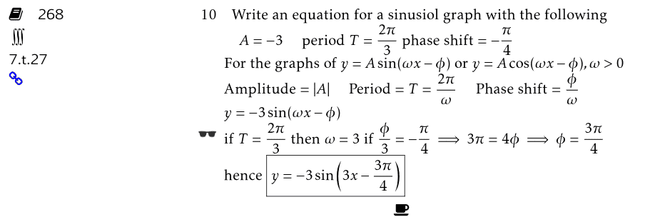

Write an equation for a sinusiol graph with the following
\quad $A=-3$ \quad period $=\dfrac{2\pi}{3}$ phase shift $=-\dfrac{\pi}{4}$
For the graphs of $y=A\sin(\omega x - \phi)$ or $y=A\cos(\omega x - \phi),\omega>0$
Amplitude $=|A|$ \quad Period $=T=\dfrac{2\pi}{\omega}$ \quad Phase shift $=\dfrac{\phi}{\omega}$
$y=-3\sin(\omega x - \phi)$
ok, I still get ? with these sinusol graphs

You have the equations! Solve for [math]T = 2 \pi / 3[/math] so solve for [math]\omega[/math]. Then find [math]\phi[/math].

ok I think this is it ... typos maybe
