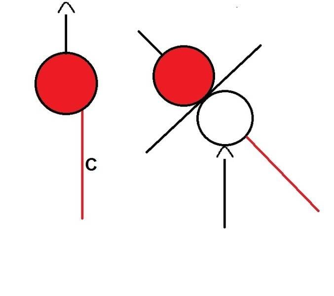

Hi, let me ask probably dumb questions to physics experts... Why does the cue ball goes almost straight when its right (or left) side is struck by a cue (right English)? This is quite different from when a ball hits another ball, in which case the ball goes almost perpendicular from the contact surface. Here, I want to focus on the ball direction immediately after the impact and ignore the curve after the ball starts to roll.
I heard that it is because the ball and cue can be thought as unity so the force only propagates to the cue direction. But if so, would it be possible that the cue makes the ball spin? My guess is that the friction between the ball and cue tip makes the ball not only spin but also go to the right direction and counteracts the force perpendicular from the contact surface (left), resulting that the ball goes to the cue direction? I heard that the friction coefficient is pretty high ~0.6. Any comments will be appreciated!

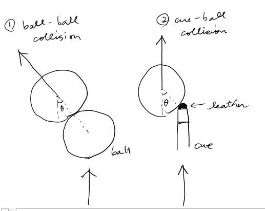

To make it clear, I posted a drawing. Why does a ball go to different direction between ball-ball and cue-ball collision?
The answer is indeed friction. The acceleration is not parallel to the normal of the contact point, so there must be a tangential component to the force. That requires friction or adhesion. The cue tip is soft compared to the balls and the contact lasts much longer than a ball to ball collision. The cue tip deforms, effectively sticks to the ball, and forces it along in the same direction the cue tip is traveling. It is something like throwing the ball rather than a hard elastic collision. During the contact with the cue the cue ball does indeed slide across the felt. This is easy to see if you look for it.
The need for high friction, or even adhesion is the purpose of chalk. A miscue is the result of the cue slipping along the surface of the ball. This happens when the friction is low due to lack of chalk, the contact is poor due to a poorly shaped, worn, or hard tip, or the friction required exceeds the friction available because the ball was struck too far off center and the tangential component is too large. Even with sticking the ball will deflect some. I've seen claims that say the stickier the chalk the less the cue ball deflects off axis. However that doesn't make sense to me. Either the cue tip slips or it doesn't. Once you've avoided slipping more stickiness is not any better.
The critical difference with the collision of two balls is that they are very hard and elastic and the contact lasts a very short time. There is a little bit of friction and some nonneglible throw in ball to ball collisions. However they are much closer to an ideal elastic collision and the direction is usually very close to the normal. On the other hand, accounting for the throw particularly at thin angles is part of what separates a good player from the rest of us.

poolplayer said:
But, if a cue ball collides with the right side of an object ball, the object ball goes to the left, right? What is the difference between the ball-ball collision and ball-cue collision? I am sorry, but I am really weak at physics... I guess this is a very basic question.
On the right side the red line shows the part of the force that applies to the object ball. The rest of the momentum is carried away by the white ball whereas the cue doesn't take any momentum to a different direction.
Likes poolplayer

Thank you for your answers! I am still trying to understand the insights into momentum conservation (if so, is cue ball direction different when hit by rolling ball and ball-in-hand?). But friction explanation makes a lot of sense to me.
You know cue makers sell "low-deflection" cues with low density (mass) at the cue tip. Striking with a low-deflection cue with right English, a cue ball goes even more straight with less deflection to left direction. Is this probably due to increase in contact time between the cue and ball (because the cue is softer) and more friction*time to the right direction (and maybe less coefficient of restitution reduces the cue ball deflection to left)?
My thought is that if it is friction that makes the cue ball go straight, it would be theoretically possible to make the cue ball to the same direction as English if friction force can be increased (one could strike the right side of a ball and the ball goes to the right).
If you took the cue ball in hand and rammed it straight ahead through the object ball without deflecting I believe you would find that the object ball still goes off at an angle.
I am pretty sure that the ball goes off though I haven't tried it.

That comment worries me. Momentum (linear and angular) still has to be conserved. The cue / arm / rest of the world have a momentum change due to the collision. The resulting velocity change of the cue is 'near' zero because the effective mass is so high.
This would happen for a collision in space, with no contact with the ground. Whatever happens, due to friction etc., is a separate issue - total Momentum will still be conserved during the spinning interaction. The initial motion (Impulse) will be to the left but any friction effect of the ball spinning will be in addition to this and happens after the contact with the cue.

I think you are right... Is this because the friction force is product of friction coefficient (<1.0) and the force perpendicular to the impact surface?
I was wondering whether the softness of the cue tip could reduce the initial velocity of the ball to left by reducing restitution coefficient or spring constant so that the friction force dominates and ball goes to right... I also noted that the cue could be bent to right during the impact (right English). I am not sure whether this bend significantly affects the ball direction though (I guess the bend increases both friction force to right and bouncing force to left)

In case you doubt that the cue ball goes straight with right English (struck right hand side), I put a little movie (20-times slower than actual time). You can see the cue ball direction (yellow line) is far from normal to the contact surface (red line). So some significant force should be taken into account. I now think that it is friction, although I am not sure how strong it is with the relatively short contact time (a few milliseconds at most, typically 1 ms). There may be other significant components. You can see that the cue waggles a lot after impact, indicating significant cue deflection.
Billiards are probably the simplest sports in terms of physics and I don't see any obstacles to measure everything in Billiards.

To some degree the inertia of the cue matters, but don't forget you are holding the cue. It is constrained by the force of your hands. If the cue was sliding through a fixed bearing instead of your bridge hand so that it really couldn't move, then the contribution of the inertia of the cue to the left/right deflection would become almost completely unimportant and the elastic bending of the cue would be the dominant contribution to the deflection of the cue at the contact point. I suspect a good bridge hand is closer to this highly constrained case than the free body case that makes the inertia of the cue important.

It is just friction. It is not in the subconscious of the skilled player. It is in the softness of the cue tip and the coating of chalk. Note that the contact between the cue and the ball persists for a significant distance. The ball did not bounce off the cue in an elastic collision.
English can be applied at various locations but this is the result you get even when it is directly right of center on the equator. I'm sure that is what poolplayer will tell you he did as that is what he was trying to demonstrate. Practically everyone who plays pool with any regularity does this all the time and we know that the cue pretty much goes straight regardless of where around the center we strike the ball unless we miscue. (We exceed the limit of static friction and the cue slides)
