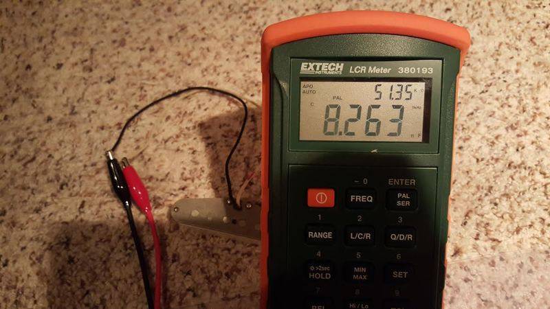

So I have two single coil pickups, both wound with the same gauge of wire, both feature six AlNiCo 5 pole pieces. This is what I measured:
"Cooler" Pickup A:
DC Resistance: 6.33 k ohms
L @ 120 Hz: 25.52 H
L @ 1 kHz: 3.070 H
C @ 120 Hz: 65.7 nF
C @ 1 kHz: 8.231 nF
"Hotter" Pickup B:
DC Resistance: 8.20k k ohms
L @ 120 Hz: 33.52 H
L @ 1 kHz: 4.050 H
C @ 120 Hz: 50.1 nF
C @ 1 kHz: 6.23 nF

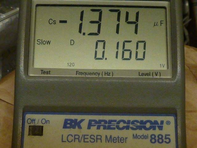

OK. Your numbers show me what's going on. You are simply changing the setting of the LCR meter to read either inductance or capacitance with the same component (one of your pickups) connected to the meter. If you look closely you should see a minus sign in front of the reading when you're in capacitance measuring mode.
LCR meters show a negative capacitance when an inductor is the component you're measuring. Similarly, they show a negative inductance when the component you're measuring is a capacitor.
For example, if you have a 1 uF capacitor (something other than an elecrolytic) and measure it at 1 kHz with your LCR meter in inductance mode, it will measure about -25.33 millihenries.
The upshot of this is, you can't measure the parasitic capacitance the way you're doing it.

Thanks for the links. It's clear to me now after rereading your, and some of the earlier posts, that this meter was never measuring parasitic capacitance, and that it can instead be worked out from the resonant peak of the coil.
The Extech 380193 LCR meter doesn't show a negative sign when measuring for C, is the negative sign implied?
Well, I've learned something from your thread. I was under the impression that all LCR meters, even the low-cost portable ones read a negative capacitance when measuring an inductance. For example, here's the reading shown by my B&K LCR meter when measuring a nominal 1 H inductor:
You can see the prominent minus sign. However, I checked the same measurement with a DER DE-5000, and to my surprise it looks just like your meter--it shows the right value but no minus sign. This is too bad. The minus sign is a good indication that the measurement is being made on a wrong setting.

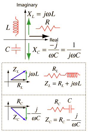

Lets look at this from a different direction. Capacitance and inductance are mathematically... weird. They are differential equations and they hurt to look at. But I think it will help if you stick with me for a second. Let's look at Capacative and Inducive Impedance (just a slightly more complex flavor of resistance).
ZL = jwL
ZC = -j/(wC)
Ok so that j is a complex number. We can think about it as a direction, or more accurately as a "unit vector." It means that it only plays with numbers that also have a j in them and has no impact on non complex numbers.
The w is a frequency, L is inductance, and C is capacitance. All of these are positive numbers.
OK so lest do something crazy. Let's assume that our frequency, inductance ans capacitance are all fixed numbers, and let's replace them with constants tomake it easier to look at.
KL for all of our inductive junk ( KL = wL) and
KC for all of our capacitive junk ( KC = 1/wC )
Our equations then become ZL = j*KL
ZC = -j*KC
Now remember that j is nothing more than a direction. You'll notice that our inductive junk is contributing the system in a positive direction and the capacitive junk is contributing to the system in a negative direction.
The result of this is, when you add them, you will always end up with one specific impedance. It might be somewhere +j or it might be -j but you will always get one number (don't tell a mathematician I said that but for our purposes it's true).
So let's say your ZL and ZC are equal. you will end up at the 0 point on the j line. The is a special point at which resonance happens.
So now that we have the background out of the way, let me address your specific questions.

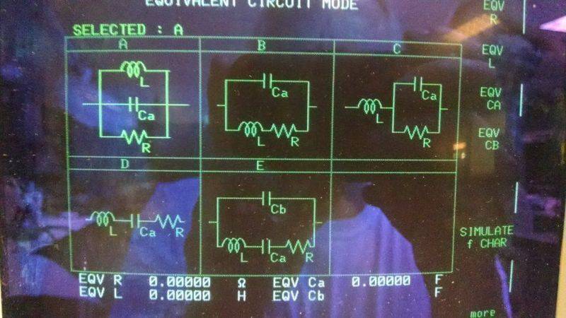

When using a vector impedance analyzer to measure parasitic capacitance of an inductor (like the HP 4194 that I posted about earlier in this thread), you can use the Equivalent Circuit feature to calculate what the various parts of the impedance are, like the DCR of the inductor, its inductance, and the parasitic capacitance. Here is a picture of the Equivalent Circuit menu on our HP 4194 (please pardon the white T-shirt reflection in the screen...):

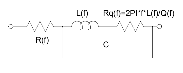

And here is an equivalent circuit from a National Instruments discussion of parasitic capacitance and inductors:
https://awrcorp.com/download/faq/english/docs/Elements/images/indqp_fig1.png
And here is the NI page that discusses the various parts of this Equivalent Circuit:
https://awrcorp.com/download/faq/english/docs/Elements/indqp.htm
It's just hard to measure the parasitic capacitance of an inductor with a hand-held meter. The method that Averagesupernova describes is a good alternative.

Quiz Question -- Which one of the HP 4194 Equivalent Circuits would probably be the best match for measuring the parasitic capacitance and DCR of an inductor? :smile:
B
Landru said:
B
Yep! :biggrin:
