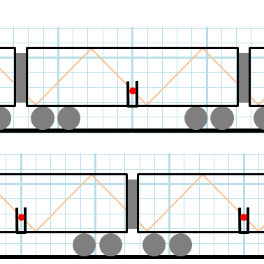

Maybe this animation helps (from an old post of mine):
Top image: ball bouncing up and down
Bottom image: ball moving diagonally
But they're both the same thing depicted in different frames.
Likes cianfa72, Orodruin, PeroK and 3 others
I see. Very good. Thanks! This really helps to visualize how a light beam through a tube would work. I suppose laser light is the same -- the coherence would depend on the motion and direct it laterally to match the motion. I don't really know anything about lasers.
@JuanGC it would be interesting to know what you think of this animation? Is it right? Or, wrong? Does it apply to a little red ball but not to light?
I thought it wouldn't apply to light, but for what I'm reading here it seems I was wrong.
Likes PeroK
It must apply to light. Otherwise you have inconsistent experimental data.
