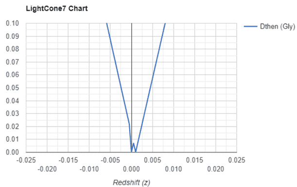

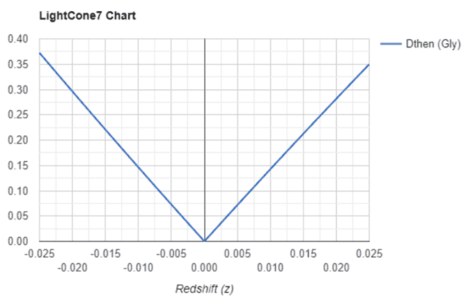

Jorrie’s Cosmo-Calculator is experiencing persistent inconsistencies in results for Dnow and Dthen compared to Gnedin’s and Wright’s calculators, particularly at low redshift values. Users speculate there may be a glitch, possibly linked to numerical integration methods used in the calculator. Adjustments to the integration parameters have shown some reduction in error but not a complete fix, indicating deeper issues in the implementation. The calculator was originally designed as an educational tool, which may explain some of its limitations. Ongoing investigations are needed to address these discrepancies and improve accuracy.
JimJCW
208
40
TL;DR Summary

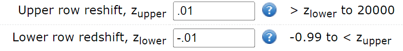

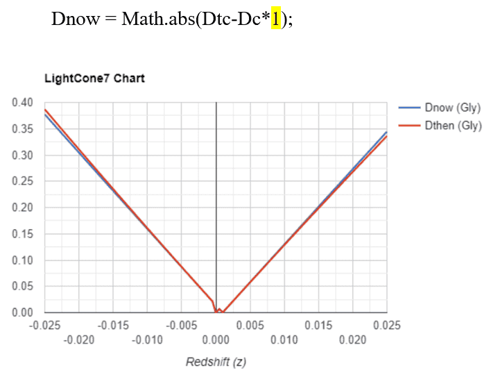

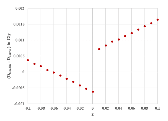

Recently I noticed that when calculating Dnow and Dthen using Jorrie’s calculator, the result is slightly inconsistent with those obtained from Gnedin’s or Wright’s calculator. Could there be a glitch in Jorrie’s calculator?
Jorrie’s LightCone7-2017-02-08 Cosmo-Calculator can be very useful and handy when making calculations based on the ΛCDM model. Recently I noticed that when calculating Dnow and Dthen using Jorrie’s calculator, the result is slightly, but persistently, inconsistent with those obtained from Gnedin’s or Wright’s calculator. An example is shown below:

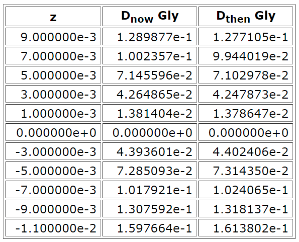

The inconsistency becomes more obvious for small z values. For example,

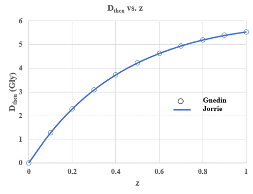

Based on the observation that the results from Gnedin’s and Wright’s calculators are consistent with each other, and that Jorrie’s result shown in the above figure is peculiar for small z values, one may wonder whether there is a glitch in Jorrie’s calculator. You can help by doing the following:
(1) Verify that there is such a peculiar result in Jorrie’s program and​
(2) Contact @Jorrie about it if you know how.​

Knowing how these calculations are done, chances are it's an issue with the numerical integration. It would make sense if Jorrie used a less-good approximation for that integral, causing this result. The behavior at low-z suggests, to me, that using a fixed delta-z for the integral might be the culprit.
By looking at the sources of the webpages
(and, in some cases, the list of .js files called as scripts),
one can find the underlying calculations of these three resources.
As @Vanadium 50 suggests, it probably would be good to be able to obtain the results from one's own calculation. I think it makes it easier to order to understand what others have done... and possibly identify different approaches that may lead to the discrepancies that you note.

It seems that in the process of evolving the calculator so that the 'future', i.e. "negative redshifts" could be visible, the distance parameters got out of step with the redshift parameter by a small amount. I will have to investigate deeper to fix.

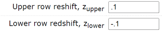

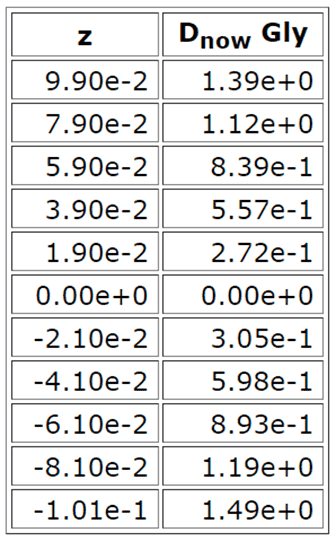

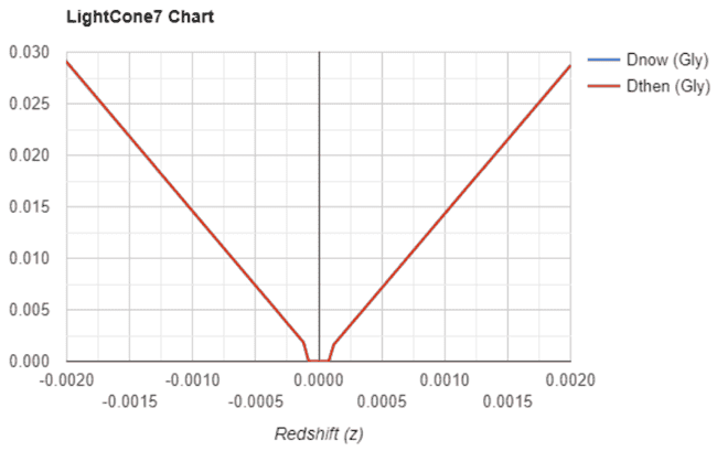

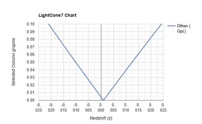

Using the 2021 version of the calculator, I get a different result:
Note that Dthen is in Gly.
Apart from the anomalous shift to the right, taking into account the Gly/Gpc distance scaling, it is only the single data point at the origin that is different between the two graphs. The latter is an easily fixable error. The shift to the right is more troublesome, due to the way that the algorithm was implemented, requiring somewhat of a reprogramming. Will hopefully get around to it soon.
I think these anomalies were not noticed before, because for larger redshifts they disappear in the noise. Cool that you have spotted them. :-))

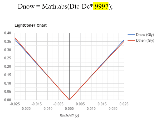

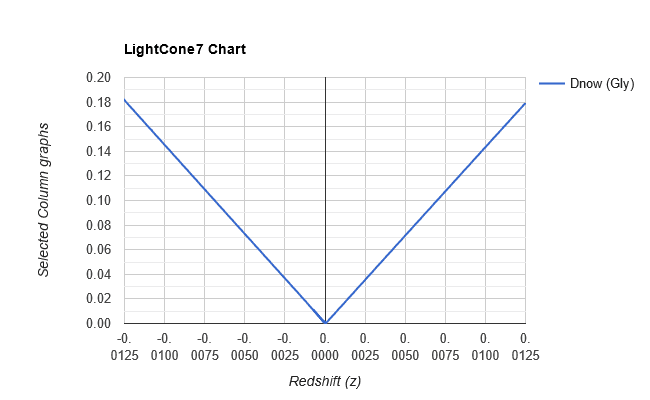

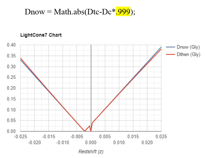

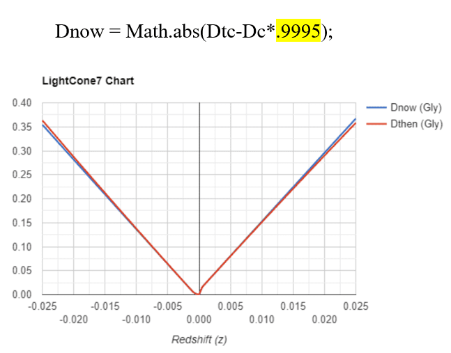

I did some experiments with the calculator and noticed the following:
If we change the ‘number of fine grain steps’ and ‘fine grain steps’ in the Calculation.js file from
N = 10000000​
sf = 0.00001​
to
N = 1000000000​
sf = 0.000001​
We can get the following result:
While this reduces the effect of the glitch, the glitch is not completely eliminated (see the following result for smaller z):
Does this suggest anything?
JimJCW said:

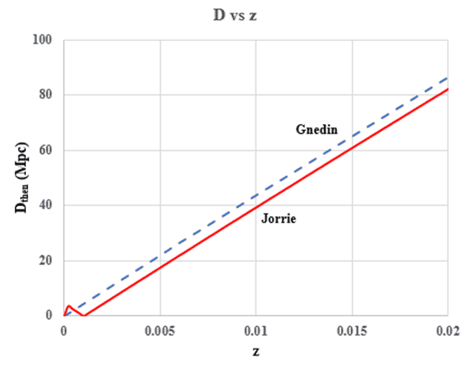

... While this reduces the effect of the glitch, the glitch is not completely eliminated (see the following result for smaller z):

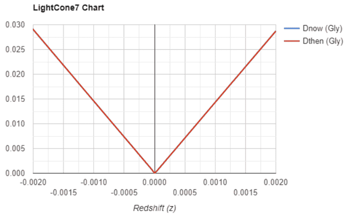

Yup, tightening the integration loops always helps, but it slows things down quite a bit. It was more of a problem when the calculator was first prototyped (around 2009), so I guess one can now insert your values for the faster computers of today.
However, the factor 100 tightening of the loops just reduces the error for the very low z by a factor 100, so it does not fix the real problem in the implementation. I'm still looking at that.
The problem with 'funnel' shape around the origin is easy to fix, at least temporarily, by taking out the statements in lines 241-245,
if (Math.abs(a-1) < 0.0001)
Dnow = 0;
Dthen = 0;
which forces Dnow and Dthen to zero for a very close to 1 (i.e, 'now').
The issue should disappear when the 'asymmetry problem' is fixed.

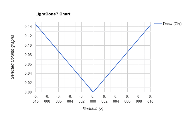

You are right; if I do the following:
if (Math.abs(a-1) < 0.000001)​
// if (Math.abs(a-1) < 0.0001)​
Dnow = 0;​
Dthen = 0;​
I get this:
Cool! :cool:

I have been playing with Line 248 of the Calculation.js file:
Dnow = Math.abs(Dtc-Dc);​
Here is my result:
I don’t understand what is going on, but hope you can see something interesting here.
One should not need to put correcting offsets into that subtraction The problem arises because both De and Dtc are the result of a massive integration loops and at z=0, they do not agree (they should be equal and they are not). I think it is differences in round-off errors in the two loops that causes it.
Essentially, Lightcone's z can run from near "positive infinite" to near "negative infinite". I think it will be better to start at zero and work towards the two extremes,, but this may case other issues.
I'm slowly working towards such a solution, and I may ask you guys to help with testing.

Here is a patched version of Lightcone7, dated 2002-05-14, which numerically corrects for the offset in the low-z regime.
When testing in that regime, remember to set zlower and zupper in the input boxes to a range compatible with the z-regime of interest. When simply run over the default range of z, it produces too course an output for proper testing.
There are still anomalies around z=0, but it is good to remember that the homogeneity condition required by LCDM does not hold for z < 0.025 or so, roughly the value for the Como cluster.

I will look at it tonight. I noticed the following:
When specifying the following:
I got this:
The ranges of z values seem not consistent.
First, the output z range is still different from the input z range:
I did the following experiment:
If I calculate Dnow using Gnedin's and your 2022 calculator and plot 'DGnedin - DJorrie' vs z, I expect to see points fluctuating around the Dnedin - DJorrie = 0 line. But I got the following result:
I wonder what clues we can get out of this.
  • #37
@JimJCW - You asked: Please let me know the line number and file name concerning the '1.001 + z' problem
In my python version there's a line near the bottom with a comment saying something like "to replicate a bug in Lightcone7 uncomment this line". In the Javascript version, no idea. I noticed it in the output - if you turn on both the ##S## and ##z## columns and bump up the number of dps they display with you can verify it yourself by calculating ##S-z##, but I don't know why it happens.
Hi Jim, yes there is that difference, but that's not the problem, the inputs range must just be a little larger than the output range. As long as the distance now output is correct for the displayed z, that's acceptable for now.
For a trial, I've just subtracted 0.001 (line 274 in the 2022-05-14 version) from the output z in order to cancel the origin's horizontal offset, which is caused by the way the distances are computed in the legacy algorithm. The question is: are those (new) values correct? Perhaps you can check it against Gnedin's.
I know that this is not the right way to handle it, so we should be investigating a purer algorithm, like @Ibix is looking at. My own time is slightly limited atm, but I will keep watching and contributing as it hopefully develops as a community project.
Thanks for contributing!

Would you please calculate the following Dnow values using your calculator so I can do some comparison?

I am puzzled by the plot shown in Post #36.
  • #45
I think the puzzles will go away if we get the distances algorithm sorted out.
Likes pbuk
