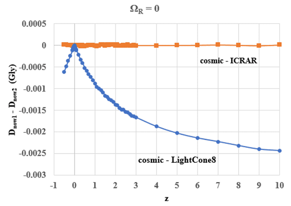

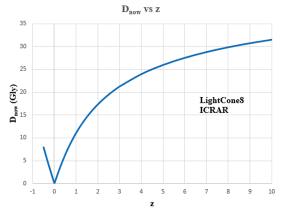

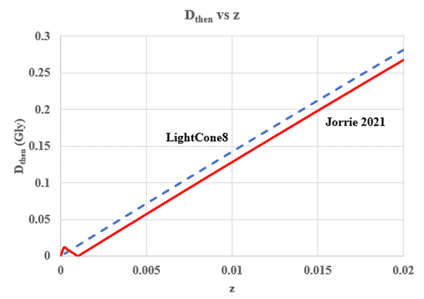

Hi @Jorrie, @pbuk,
Let’s review the current situation of Jorrie’s calculator. First, LightCone8 updated by @pbuk has eliminated the glitch discussed in this thread (see Post #1):
ICRAR is an online calculator that includes ΩR,0 as an input parameter, just like LightCone8 (zeq = 3370). A comparison of the calculated Dnow’s using the two models is shown below:
The two results are almost indistinguishable. However, when their difference is plotted against z, the result shows,
The fact that ‘ICRAR - LightCone8’ is not a horizontal line near y = 0 suggests that there exists discrepancy between the two calculators. To look into this further, we note that ICRAR (ΩR=0), LightCone8 (ΩR=0), and cosmic (no ΩR) should give the same results, but they don’t:
The figure suggests that when ΩR=0, ICRAR and cosmic are consistent with each other, but not with LightCone8. The source of this discrepancy is unknown. It would be nice, though, to be able to identify it.
To summarize:
LightCone8 has removed the glitch discussed in this thread. However, it is noticed that there exist discrepancies between LightCone8 and some other online calculators, such as ICRAR and cosmic.​

My first suspicion is the values of certain constants, particularly the conversion factor from ## km\\s^{-1}\\Mpsc^{-1} ## to ## Gyr^{-1} ## which is a simple ## \frac 1 {978} ## in LightCone8 instead of something like ## \frac{365.2421897 \times 86400 \times 1000000 \pi}{96939420213600000} ##.
I've raised an issue and will look at it: https://github.com/light-cone-calc/light-cone-calc/issues/11

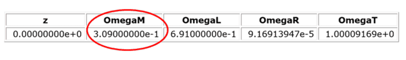

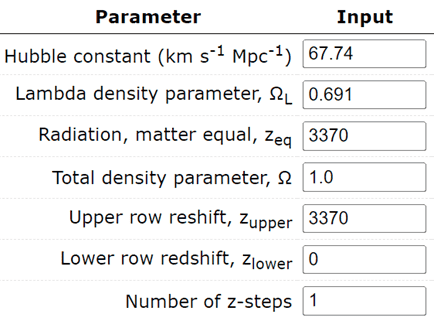

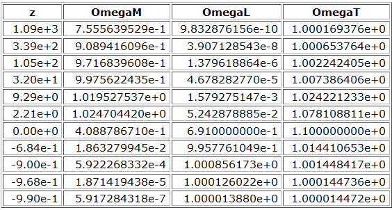

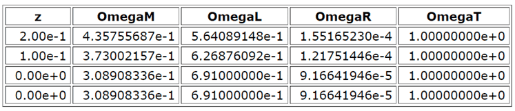

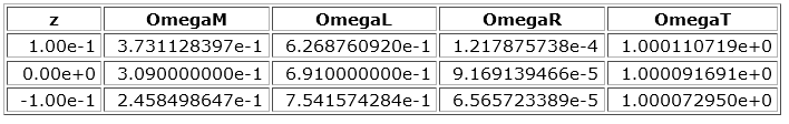

Hi @Jorrie and @pbuk,
I noticed some discrepancies in results from LightCone8. Let’s use the following input values:
Equations in Tutorial, part III,
Ωm = (Ω - ΩΛ) Seq / (1 + Seq), where Seq = zeq + 1​
ΩR = Ωm / Seq
give,
Ωm = 0.308908363
ΩR = 0.000091637
These numbers are compared with output of LightCone8 below:
z
OmegaM
OmegaL
OmegaR
OmegaT
LightCone8
0​
0.309000000​
6.910000000
0.00009169139​
1.000091691​
From Equations
0​
0.308908363​
6.91​
0.000091637​
1​
Note that under Conversions in the output, LightCone8 gives,
Conclusion: The values of Ωm and ΩT calculated with LightCone8 are questionable.

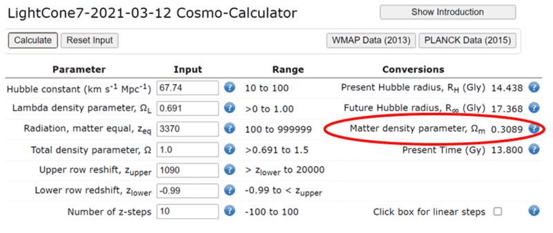

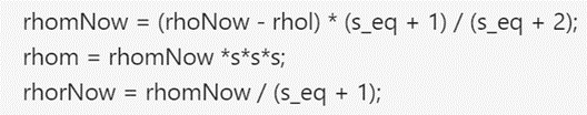

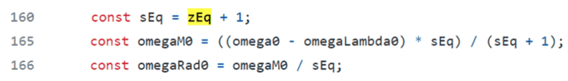

Would you please let me know where in Jorrie 2021 calculator the circled number shown below is calculated and printed, for example, lines numbers in Calculation.js. I am trying to understand the discrepancy discussed in Post #105.
  • #108
It is calculated in the main html program, not in Calculate.js
line 356 var OmegaM = (Omega-Ynow * Ynow / Yinf / Yinf) * s_eq / (1+s_eq);
I'm not sure if this should have been "z_eq / (1+z_eq) "
Also take note that it is expressly rounded to 4 decimals for that calculation.
When calculated later in the tables, it is rounded to the requested number pf decimals.
Ps: The densities for the tables are calculated in
Calculation.js line 27: var Om = (Omega - Ol) * (s_eq + 1) / (s_eq + 2);
The (s_eq + 1) / (s_eq + 2) is a mistake that has been prviously pinted out and corrected in Lightcone8 by @pbuk. There is some further processing in lines 243 to 250.
These line numbers are only relevant to the LightCone7-2021-03-12 Version

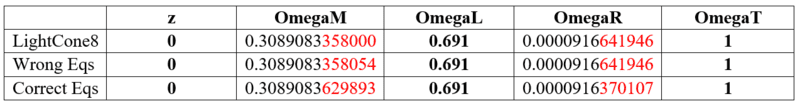

  • #112
pbuk said:
I think the error is in the UI: we should have ## \Omega_{m,0} = \Omega - \Omega_{\Lambda,0} = 1 - 0.691 = 0.309 ##.
I have checked the UI calculation and it seems to be right if radiation density is included, as it should.
##\Omega_{m,0} = 1-\Omega_{\Lambda,0} - \Omega_{r,0}= 1 - 0,691 - 0,000091637 = 0,308908363##
I obtained the value of ##\Omega_{r,0}## by substituting ##\Omega_{m,0} = S_{eq} \Omega_{r,0}## into the balancing equation.
On the other hand, if I set the columns for enough decimal places in Ligtcone8, ##\Omega_{T,0}## does not equal 1.
So the error seems to lie in calculation.js for the columns.

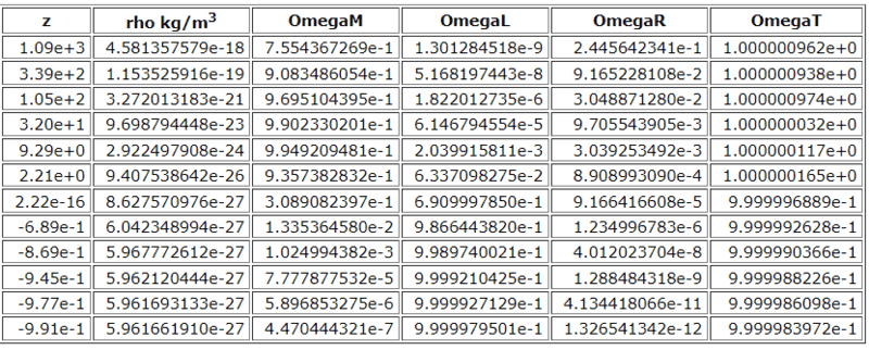

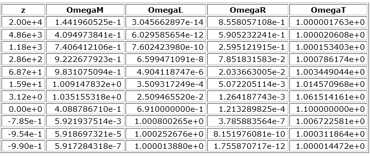

  • #115
pbuk said:
There's a few other oddities I'm coming across, I think I'm going to end up rewriting the physics from scratch (which means I'm going to have to learn it first!)
Yes, the same differences occur in Lightcone7, but it is calculated differently than the value in the UI. I will check that part and make it compatible, because I still feel that the value in the UI is correct.

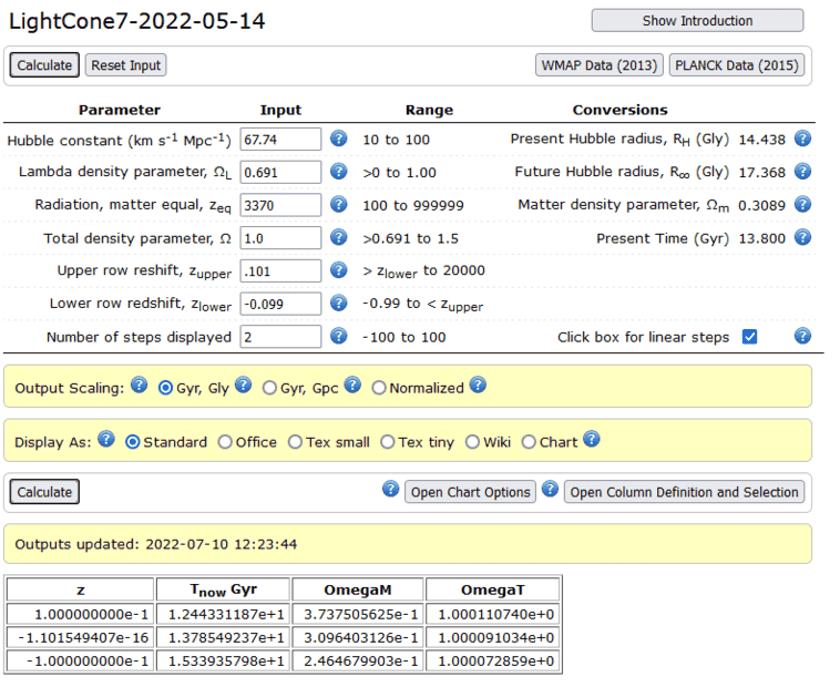

  • #116

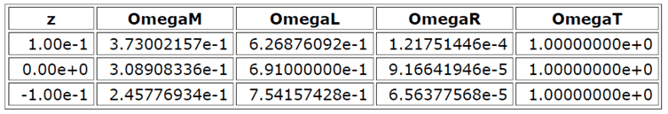

Minor corrections (red) in Calculation.js required to improve the issue:
var Ol = (Ynow / Yinf) * (Ynow / Yinf); // Lambda density parameter
var Om = (Omega - Ol) * s_eq / (s_eq + 1); // matter density parameter (corrected for radiation)
var Or = Om / s_eq; // Radiation density parameter (corrected for error; was /(s_eq+1)
var Ok = 1 - Om - Or - Ol; // curvature density par
rholNow = rhocritNow * Ol;
rhol = rholNow; // vacuum energy density remains constant
rhomNow = (rhoNow - rhol)*s_eq/(s_eq+1); // Matter energy density corrected for radiation
rhom = rhomNow *s*s*s; // Matter density at time T
rhorNow = rhomNow/s_eq; //radiation at present
rhor = rhorNow *s*s*s*s; // radiation density at time T
rhoT = rhol+rhom+rhor; // total energy density at time T
rhocrit = rhoConst*(H_t/secInGy)*(H_t/secInGy); // critical density at time T
OmegaMatterT = rhom/rhocrit; // Omegas at time T
OmegaLambdaT = rhol/rhocrit;
OmegaRadiationT = rhor/rhocrit;
OmegaTotalT = rhoT/rhocrit;
In Lightconne 7, it gives the correct matter density of 0.308908 at z=0 and a more accurate OmegaT. The drift in OmegaT may be rounding off in Lightcone 7. It will be interesting to see what it does in Lightcone8 with its improved calculation module.
  • #117
George Jones said:
Yes, at any time, ##\rho_{0} = \rho_{r,0} + \rho_{m,0} + \rho_{\Lambda,0}##. In the case ##\Omega = 1##, this is subject to the constraint$$\rho_{0} = \rho_\mathrm{critical} = \frac{3 H_0^2 }{8 \pi G},$$
since ##\Omega := \rho/\rho_\mathrm{critical}##.
George, how do the equations change in the case where ##\Omega \ne 1##?
I'm asking because I don't think Lightcone7 gives the correct results in such a case.

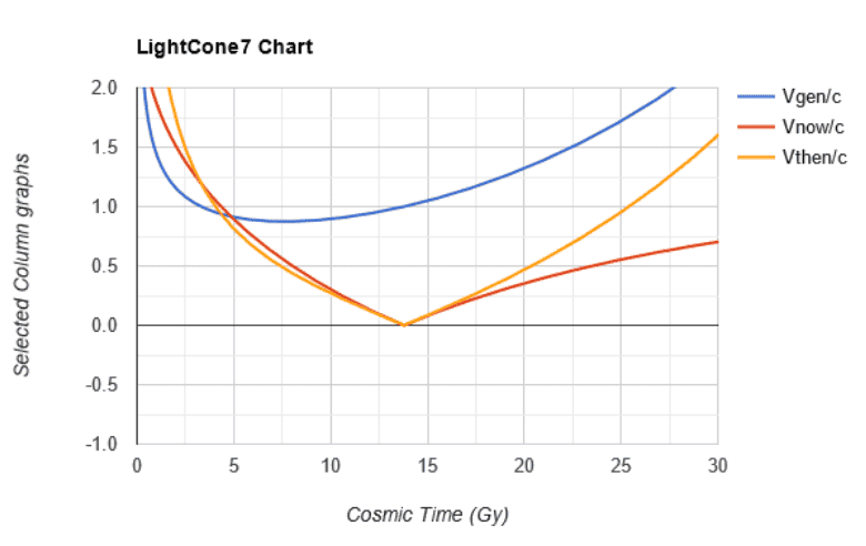

I only have one variable I don't quite understand - I've called it vGen, it's called XDpar in the LightCone7 code but displayed in the table as ## V_{gen} / c ## and has the description
Is there anything snappier/more descriptive than vGen?

  • #130
AFAICR, the late Marcus and I were thinking of the worldlines of generic particles that presently cross our Hubble sphere. The variable XDpar appeared in the discussion as the ratio Vthen/Vnow and it was specifically included in the columns for purposes of plotting that interesting wordline mentioned. This is how Vgen[eric] came to be. It shows "dramatically" how a particle could enter the Hubble sphere early on and then be accelerated to cross it again, in the generic case, right now.
We used it to work out the crossing and inflection points.

Great Job! Now we have the UI and the tables agreeing on ##\Omega_m## and also ##\Omega## staying at precisely 1. 00... I have also checked that for ##\Omega \ne 1## the behavior seems to be as expected (and interesting!).
##\Omega## had to start very much closer to 1 and diverged to the requested 1.1 at present, but then the cosmological constant will drive it back towards 1 (for ##w=-1## at least)

I think these changes are incorrect. The following statements near Line 27 and Line 325 in Calculation.js,
correctly represent the following equations (note that s_eq = zeq in LightCone7),
Ωm = (Ω – ΩΛ) (zeq + 1) / (zeq + 2)​
ΩR = Ωm / (zeq + 1) .​
They are consistent with equations in Tutorial, part III:
Ωm = (Ω - ΩΛ) Seq / (1 + Seq)​
ΩR = Ωm / Seq ,​
where Seq = zeq + 1.
However, the following statements near Line 261,
should be changed to,
rhomNow = (rhoNow - rhol) * (s_eq + 1) / (s_eq + 2);​
rhom = rhomNow *s*s*s;​
rhorNow = rhomNow / (s_eq + 1);​
I believe this is the source of the error discussed in Post #109. @pbuk

Hi @pbuk and @Jorrie,
I am getting some puzzling results concerning output of LightCone8. Let’s use PLANCK 2015 Data and calculate OmegaM and OmegaR with three different methods:
1. LightCone8
2. Correct equations,
3. Wrong equations,
omegaM0 = (1 - OmegaL0) * zEq / (zEq + 1)​
omegaR0 = OmegaM0 / zEq
The results are shown in the table below:
Is it possible that the LightCone8 result is calculated with the wrong equations?
No, I have looked into it and it is more subtle than that. The problem is that LightCone8 uses the same mapping to the UI as LightCone7 which does not pass the input value of ## \Omega_\Lambda ## directly to the caculations, it actually passes
$$ \left ( \frac{\frac{978}{H_0}}{\frac{978}{H_0\sqrt{\Omega_\Lambda}}} \right )^2 !$$
This obviously introduces roundoff error, and because of the sqaring with a 53 bit mantissa I'd expect only about 8 decimal digits of accuracy - your calculation shows ~7.5. The fact that a similar result occurs when taking ## z_{eq} ## instead of ## s_{eq} ## is coincidence.
I can easily fix this by changing the inputs to the back-end to read directly from the input fields.
  • #147
Well I did that, which was very worthwhile but it didn't fix the problem, which was actually less subtle: the input field that is labelled ## z_{eq} ## was actually
HTML:
<input name="s_eq" />
so while it looked as though the conversion ## s_{eq} = z_{eq} + 1 ## had been done, it never was!
I have now fixed this, and tidied up the credits and a couple of other things, enjoy.

Great! Now we have,
z
OmegaM
OmegaL
OmegaR
OmegaT
LightCone8
0.3089083630000​
0.691
0.0000916370107​
Wrong Eqs
0.3089083358054​
0.691
0.0000916641946​
Correct Eqs
0.3089083629893​
0.691
0.0000916370107​
  • #149
Thanks, of course the UI only displays a maximum 9 digits, the results at full precision are:
  • OmegaMatterT: 0.3089083629893239
  • OmegaLambdaT: 0.691
  • OmegaRadiationT: 0.0000916370106761566
  • OmegaTotalT: 1

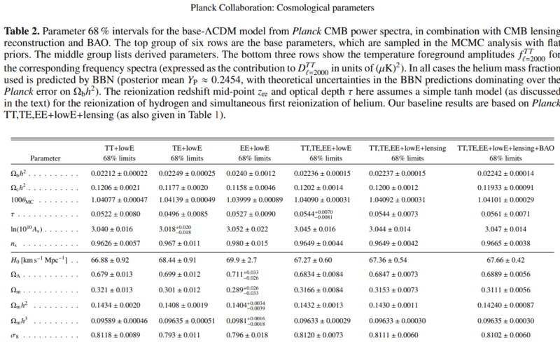

Could be nice to have for model comparison, but we know the cosmological inputs to no better than the 4th digit, with ##H_0## the main constraint. A more important UI change would be to have the latest (2018/2021) Planck data release as an option.
Also, historically, LightCone has concentrated on the ##H_0## and ##\Omega_\Lambda## as base inputs. This was partially because the late @marcus had a lot of threads explaining the usefulness of having ##\Omega_\Lambda## a parameter.
However, the Planck base group of sampled data does not include ##\Omega_\Lambda##, but rather the two matter densities: baryonic and dark - see Table 2 on page 16 in the paper (partially shown below) - which they then statistically add together to get ##\Omega_m##. So ##\Omega_\Lambda## is a derived parameter in their books.
In the past data releases, we took the LightCone inputs from the last row of the second group of derived inputs in Table 2. I suggest that we keep on doing that, except for giving priority to ##\Omega_m## rather than ##\Omega_\Lambda##, the latter becoming a derived parameter.
Before we change the mapping between the UI and the calculation module, I think we should decide on this.
