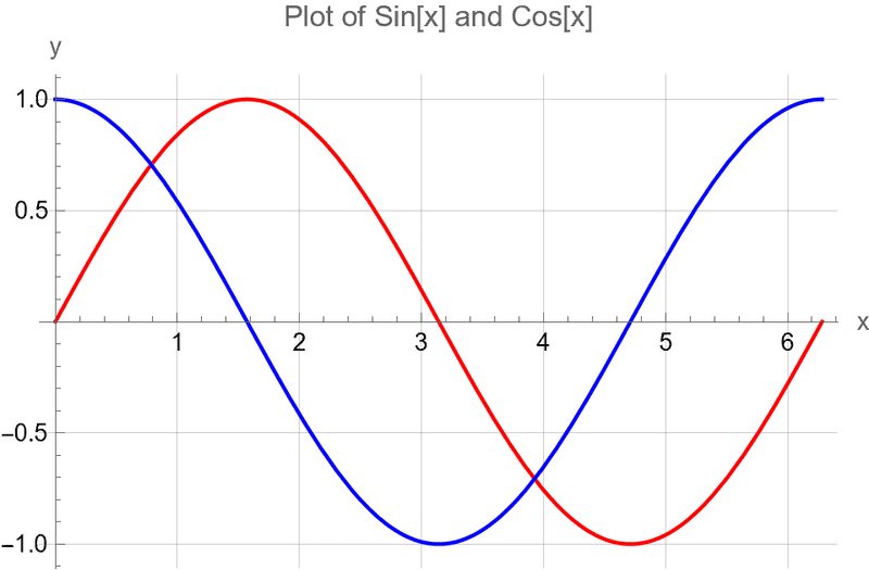

Hello :
Trying to remember a Mathematica code (plot)
If I want to plot two function on the same screen in the following way
F(x) = f( qi)/f(bn) which i = (0,...,n), n =(0,...,m)
For every value of i we plot F(x) for all the valuse of n for example F(x) = f(q0)/f(b(n=0,...,m) ),...etc
When I use the plot function it looks like it is ploting the function this way
F(x) = f(q(i =0,...,n))/f(b(n=0,...,m))
Best Regards
H
So there's a couple of ways I found from searching the question:
1) Use GraphicsRow to plot them in separate plots side by side
2) Use GraphicsColumn to plot them in separate plots stacked on top of one another
3) Use Plot as shown in the example below:
[CODE lang="python" title="Mathematica plot of sin and cos from 0 to 2pi"](* Define the functions *)
f1[x_] := Sin[x]
f2[x_] := Cos[x]
(* Plot both functions on the same graph *)
Plot[{f1[x], f2[x]}, {x, 0, 2 Pi},
PlotStyle -> {Red, Blue},
PlotLegends -> {"Sin[x]", "Cos[x]"},
AxesLabel -> {"x", "y"},
GridLines -> Automatic,
PlotLabel -> "Plot of Sin[x] and Cos[x]"][/CODE]
Note: I don't have Mathematica so I couldn't test this example. Your mileage may vary.
Here's what @jedishrfu's Mathematica example code evaluates to:
