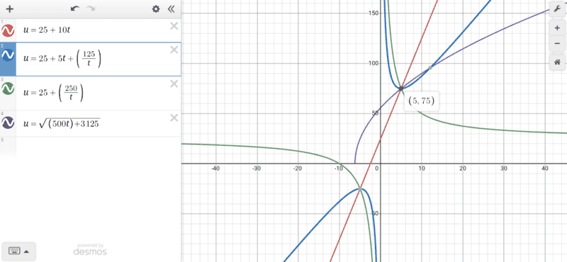

Here's a graph of the 4 equations.
The question is - why did the second function have a minima while others didn't.

What I meant was if we take the maxima of the four functions of u(t), which are:
$$u=10t+25$$
$$u=25+5t+\frac{250}{t}$$
$$u=\frac{25t+250}{t}$$
$$u=\sqrt{500t+3125}$$

The second equation calculates the time, ##t##, for the bullet to hit the balloon:
$$ut -\frac 1 2gt^2 = (25 \ m/s)t + 125 \ m$$Which reduces to:
$$u = (25 \ m/s)t + \frac 1 2 gt + \frac{ 125 \ m}{t}$$You can look at this as ##u(t)## being function of the time taken, ##t##. And, by differentiating ##u(t)## you can actually find the minimum possible ##u##.
The other equations, I assume, are not calculating the time ##t## to hit the balloon. In any case, the other equations make no sense to me.

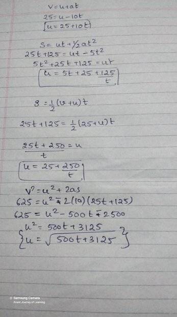

Yes they all represent the initial velocity of the bullet
This is how I got them.
The issue is that on finding the minima of u(t) - I get the right answer for only the 2nd equation. The other have no minima, as can be seen from the graph in OP

The four equations in #3 were rearranged from the four equations in #1. What is not OK is the use of all four equations to find the minimum. That's because equations 3 and 4 in post #1 do not bring to the table anything new. They can be readily derived from the first two equations by eliminating one variable or another and all 4 equations are applicable to any problem where the acceleration is constant. In this particular problem substitutions of functional form for ##s## and ##v## and a number for ##a## adapt the equations to this particular problem, nevertheless equations 3 and 4 are still linearly dependent on 1 and 2. All one has to do, given post #3, is solve the first two equations as a system of 2 equations and two unknowns and ignore equations 3 and 4. This, by the way, is the traditional approach.
Likes Lnewqban, Shreya and PeroK
One of your problems here is a sloppiness in notation that many books follow. We shouldn't really use ##t## for both the continuous variable of time and the fixed time of the collision. For this we should use ##t_0## or ##t_1## or ##T##.
An equation like ##v = u + at## is just a general equation for the velocity of the bullet. It carries no specific information about this problem.
The second equation, however, is an equation for ##T## the time to hit the balloon:
$$u = (25 \ m/s)T + \frac 1 2 gT + \frac{ 125 \ m}{T}$$That equation contains all the information about the problem: in particular the initial height and speed of the balloon. We would normally think of ##T## being a function of ##u##: choose an initial speed, ##u##, and (assuming it's large enough) we get some time ##T## of impact.
Turning this round, we can look at choosing an impact time ##T## and, assuming its short enough, we can find the initial speed that gives that impact time.
Then we notice that minimising the speed with respect to possible impact times solves the problem.
Your problem is that you applied some mathematics (function minimisation) without understanding how the function related to your physical problem. And I had to piece it all together for you!

Let's analyse your last attempt. From ##v^2 - u^2 = 2as## you got:
$$u^2 = v^2 +2g(h_0 + v_b t)$$But, then you plugged in ##v = 25 \ m/s##, which destroys the minimisation approach - as this ##v## is a specific solution. Instead, you need to use ##v = u -gt## to get:
$$u^2 = u^2 -2ugt + g^2t^2 +2g(h_0 + v_bt)$$Hence:
$$2ugt = g^2t^2 + 2gv_bt + 2gh_0$$And:
$$u = \frac 1 2 gt + v_b + \frac{h_0}{t}$$Which is the same equation we got above. Again, it might be better to use ##T## to indicate the time of impact.

  • #41
Shreya said:
Awesome! Does that mean that the equations we get in 3 & 4 doesn't describe the range of ##u##s and the corresponding ##t##s we can get, but only a specific situation.
Another Silly Question - then why do we still get a function (not a number)? And doesn't the lower values of u from 3 & 4 satisfy the conditions?
Essentially you do get a number (really a quantity, as we have units involved). There's a difference between a fixed, as yet uncalculated quantity and a variable. To take a simple example.
We start with the simple equation relating displacement, constant velocity and time:
$$s = vt$$In general, all of these quantities may be variables. Note that there is a subtle difference between ##v##, which is an unknown, and ##s## and ##t## which are continuous variables.
In a single experiment, ##v## would be some fixed quantity throughout the experiment, while ##t## and ##s## vary.
If we consider varying ##v##, then we are considering many different experiments. This is the technique you tried to use for this problem. This is a valid approach, but you must be aware of what you are doing.
If we want to hit a target at a distance of ##10 \ m## then the speed and time are related by:
$$vT = 10 \ $$Which gives ##v## as a function of ##T## and vice versa. We can plot a graph of ##v## against ##T##. Note that I've been careful to use ##T## here to indicate that we have a fixed but unknown time ##T##. In any experiment we have a single ##v## and a single value for ##T##. This ##T## is not the same as the continuous variable ##t## that represents the passage of time.
In this case, there is no minimum of maximum, but we can still draw a graph of the function ##v(T) = \frac{10 \ m}{T}## or ##T(v) = \frac{10 \ m}{v}##.
Note that this is a function that represents many different experiments, with all the possible values of ##v##. In any given experiment, ##v## and ##T## are fixed (even if unknown) quantities.
Finally, if we assume that ## v = 5 \ m/s##, say, then we no longer have a function and ##T## must be ##2 \ s##. In this simple case, as soon as we choose either ##v## or ##T## then the function collapses to a single point on the graph. This is what happened above when you chose ##v = \ 25 m\s## as the final speed. You had then specified enough data to collapse the function relating ##u## and ##T## to a single point on the graph (##u = 75 \ m/s## and ##T = 5 \ s##). Even if you still had to calculate these numbers.
In particular, you no longer had a function ##u(T)## to do calculus on.
Likes Lnewqban and Shreya
  • #42
Differentiate it said:
But u and t are both unknown. u can be any value and t can be any value too, right?
No. Once you specify ##v = 25 \ m/s##, this fixes the values of ##u## and ##t##, even if you still have to calculate them.
Likes Shreya
  • #43
Hm, but how does s = ut + (1/2)at^2 take the balloon's motion into account?
Because you combine that equation for the bullet with the simultaneous equation for the motion of the balloon. If we do this formally, we have:
$$s = ut - \frac 1 2 gt^2$$and$$s_b = h_0 + v_bt$$And we set ##s = s_b## to get the equation relating the initial speed of the bullet and the time of impact:
$$uT - \frac 1 2 gT^2 = h_0 + v_bT$$This equation then contains all the information relating the initial speed of the bullet with the time of impact. Note that ##h_0## and ##v_b## are fixed quantities and not variables in this case.
Note that ##u, T## are variables here representing many different physical experiments. And we have a function relating them.
But, if we specify additionally the final speed of the bullet when it hits the balloon, then there is only one possible initial speed and one possible time. This is because if we fix ##v = u -gT = 25 \ m/s##, then we have another equation relating ##u## and ##T##. And the equation above reduces to:
$$u = 75 \ m/s \ \ \text{or} \ \ T = 5 \ s$$
Likes Shreya
  • #44
Essentially, the last 2 equations specify the final Velocity, thereby fixing ##u## & ##T##, even though they are unknown, they refer to one specific experiment. The graph has collapsed to a single point and is no longer differentiable. The value of ##u## still has to be calculated using simultaneous equations but has already been fixed on specifying ##v##. But on using ##u-gT## for ##v## I still refer to multiple experiments and multiple values of ##u## and ##t## and therefore I can use function minimization.
Please correct me if something is wrong
Likes PeroK
  • #45
Isn't there multiple values for u and t even though we fix v as 25?
We can still represent u as a function of t, it doesn't collapse it to a point
  • #46
  • #47
Yes, but let's not forget that the distance the balloon has to travel is fixed - and on fixing the final Velocity - the graph collapses to a single point which is (5,75)
Please correct me if I'm wrong
  • #48
No, it's fully constrained by specifying that it impacts the balloon at ##25 \ m/s##. There is only one physical solution for the initial speed (##u = 75 \ m/s##) and only one solution to the simultaneous equations.
You may be confusing the trajectory of the bullet, defined by ##s = ut - \frac 1 2 gt^2## and the relationship between the initial speed and the time at which the bullet hits the balloon: ##u(T)##.
It's critical to use different symbols (##t## and ##T##) for these concepts. Using the same symbol ##t## for both only works as long as you keep the concepts separate in your mind.
Likes Shreya
  • #49
I don't understand...
Also, does a function have no minima if there's 2(or maybe more) minimum values? Because here u is minimum, s and t are maximum. Whereas v is minimum. But when you substitute in say u -gt for v, instead of to minimum variables u and v, you have only u.
And the function u(t) has a minima
If yes, why?
It's probably wrong, but could you explain it more? I don't get how u is fixed to 75 if I set v = 25.
  • #50
If yes, why?
I can't explain it more until you start using ##T## when you mean the time of impact for a given ##u##.
