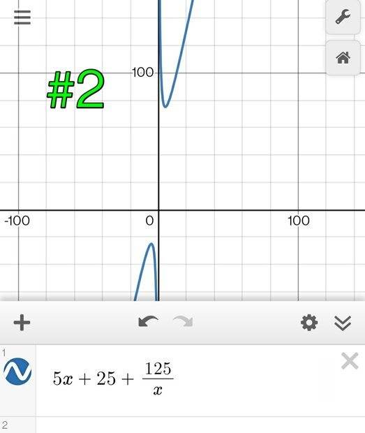

We start with the simple equation relating displacement, constant velocity and time:
$$s = vt$$In general, all of these quantities may be variables. Note that there is a subtle difference between ##v##, which is an unknown, and ##s## and ##t## which are continuous variables.
In a single experiment, ##v## would be some fixed quantity throughout the experiment, while ##t## and ##s## vary.
If we consider varying ##v##, then we are considering many different experiments. This is the technique you tried to use for this problem. This is a valid approach, but you must be aware of what you are doing.
If we want to hit a target at a distance of ##10 \ m## then the speed and time are related by:
$$vT = 10 \ $$Which gives ##v## as a function of ##T## and vice versa. We can plot a graph of ##v## against ##T##. Note that I've been careful to use ##T## here to indicate that we have a fixed but unknown time ##T##. In any experiment we have a single ##v## and a single value for ##T##. This ##T## is not the same as the continuous variable ##t## that represents the passage of time.
In this case, there is no minimum of maximum, but we can still draw a graph of the function ##v(T) = \frac{10 \ m}{T}## or ##T(v) = \frac{10 \ m}{v}##.
Note that this is a function that represents many different experiments, with all the possible values of ##v##. In any given experiment, ##v## and ##T## are fixed (even if unknown) quantities.
Finally, if we assume that ## v = 5 \ m/s##, say, then we no longer have a function and ##T## must be ##2 \ s##. In this simple case, as soon as we choose either ##v## or ##T## then the function collapses to a single point on the graph. This is what happened above when you chose ##v = \ 25 m\s## as the final speed. You had then specified enough data to collapse the function relating ##u## and ##T## to a single point on the graph (##u = 75 \ m/s## and ##T = 5 \ s##). Even if you still had to calculate these numbers.
In particular, you no longer had a function ##u(T)## to do calculus on.

I don't understand...
Also, does a function have no minima if there's 2(or maybe more) minimum values? Because here u is minimum, s and t are maximum. Whereas v is minimum. But when you substitute in say u -gt for v, instead of to minimum variables u and v, you have only u.
And the function u(t) has a minima
If yes, why?
It's probably wrong, but could you explain it more? I don't get how u is fixed to 75 if I set v = 25.

I need to see an attempt on your part to understand the difference between the continuous time coordinate ##t## and the time of impact ##T##.
Likes Shreya

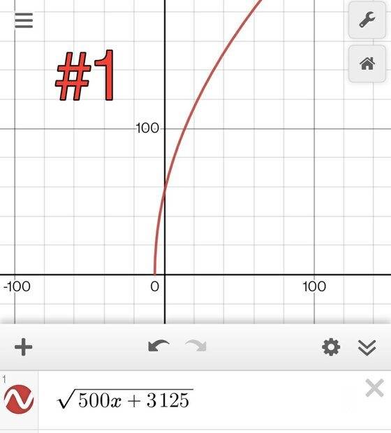

So, is this correct?:
We substitute in u - gt for v so that the function still has a minima?
If yes, could you tell which kind of functions can't have a maxima/minima ?
Also, could you answer the question made in #49 ?
  • #62
PeroK said:
What function has a minimum?
##u## is not a function of ##t##. ##u## is the initial velocity. The velocity ##v(t)## at any time ##t## is a function of ##t## given by: ##v(t) = u - gt##, where ##u## and ##g## are constants.
If you differentiate this you get the acceleration: ##a(t) = v'(t) = -g##.
Like, a linear function has no minimum( like u = v - 10t) but substituting √(u^2 -20(25t+125)) for v in, and writing as a function of t, gives -125/t - 25 - 5t, which does have a minimum. So, is the point of substituting u - gt to ensure that the function has a minimum? If yes, could you please add what kinds of functions have a minimum?
