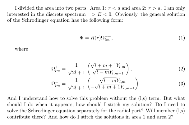

Hello everyone. Help me solve the problem. I don't understand how to handle this type of task.
Find the energy levels of a spin 1/2 particle in a potential well: V(r)+W(r)*(l,s), where V(r<a)=-U, V(r>a)=0, W(r) = q*δ(r-a)

It is clear that the problem in the potential ##V(r)+W(r)*(l,s)##, but without the (l,s) term: ##V(r)+W(r)##, simply reduces to solving the radial Schrodinger equation. And I understand how to find energy levels in such a task. But what to do when ls interaction also appears in the delta layer?
A vector product can be written like this.
##(\overrightarrow{l}, \overrightarrow{s}) = \frac{1}{2} (\overrightarrow{j}^2 - \overrightarrow{l}^2 - \overrightarrow{s}^2)##
Then maybe just transform the stitching condition?
##\Psi^{'}_{II}(a+0) -\Psi^{'}_{I}(a-0) = \frac{2m}{\hbar^{2}}*q*\frac{1}{2}(j(j+1)-l(l+1)-s(s+1)) \Psi_{I,II}(a\pm 0)##
