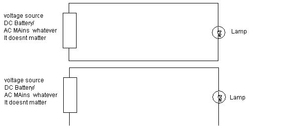

ok I will draw a basic circuit diagram for you D
Yay, diagrams!
OK which of these 2 circuits ( top or bottom) is going to work and why ??...
Then we will move onto the next drawing
Dave

Well the bottom will not work because it is an open circuit
OK good :)

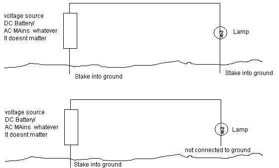

now let's change that bottom wire from the lamp to the voltage source to something else
which circuit will work now top or bottom ?
Dave

Well the bottom circuit would not work, but so far this is all compatible with the infinite sink logic
OK the bottom cct won't work because again you have an open cct... that is the circuit is incomplete, just as in your Earth moon senario
A circuit must be complete, there much be a return path, who cares what it is, the ground, a wire, a lake of water, whatever.
well we do care a little because different materials have different resistances and we like to keep resistances low to keep the power losses down. Over any given distance the Earth is going to have higher resistance than a wire. but it can be acceptable.
As Berkman said earlier ... wet ground full of salts will conduct well
but dry arid desert ground sands etc leached of all minerals is going to make a very crappy very hi resistance return path for a circuit
Dave
