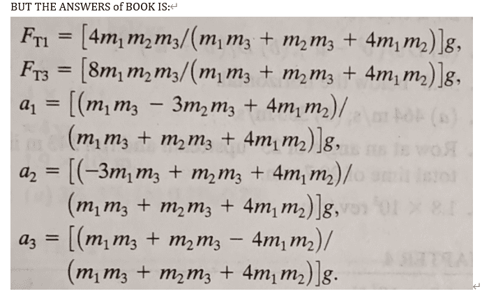

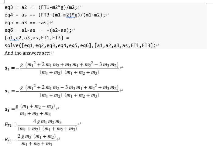

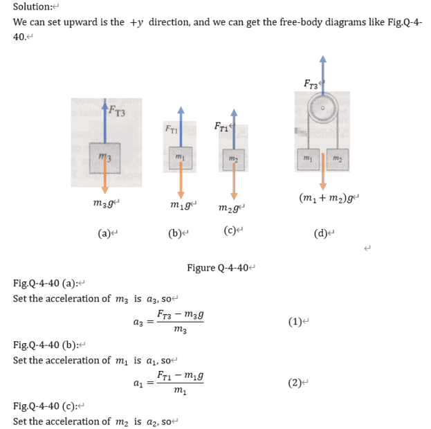

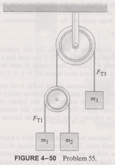

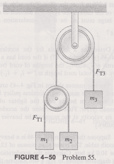

The double Atwood machine shown in Fig. 4-50 has frictionless, massless pulleys and cords. Determine (a) the acceleration of masses m1, m2 and m3, and (b) the tensions FT1 and FT3 in the cords.
My answer is different from the book‘s!
Please to see the attach file.

Hello @Minming
:welcome:

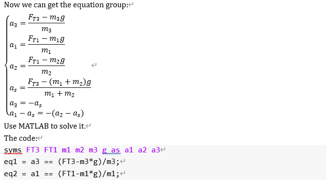

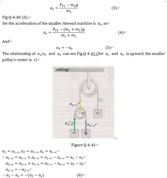

Check your eq (4)
You equation for ##a_s## doesn't look correct to me. It should involve ##F_{T_1}## and ##F_{T_3}## and not the masses m1,m2 and g, at least not directly.
Likes Lnewqban and Steve4Physics
An easier way to assemble the equations would be to consider that the acceleration of an Atwood machine pulley on the right does not depend on whether there is another Atwood machine on the left side of its cord or an effective mass ##m_{\text{eff.}}##. Assuming that ##m_3## is accelerating and moving down, the known equations for the acceleration and tension of a single Atwood machine hanging from a fixed support are $$a_3=\frac{m_3-m_{\text{eff.}}}{m_3+ m_{\text{eff.}}}g~;~~F_{T_3}=\frac{2m_3~ m_{\text{eff.}}}{m_3+ m_{\text{eff.}}}g.$$The left pulley is accelerating up with acceleration ##a_3## which means that it can be treated as a fixed Atwood machine in an effective gravitational field ##g_{\text{eff.}}=(g+a_3).## So we write $$F_{T_1} = \frac{2m_2~ m_1}{m_2+ m_1}(g+a_3).$$ We also have that ##F_{T_1}=\frac{1}{2}F_{T_3}##. This gives a second equation and hence a system of two equations and two unknowns, ##a_3## and ## m_{\text{eff.}}## $$\begin{align}
& a_3=\frac{m_3-m_{\text{eff.}}}{m_3+ m_{\text{eff.}}}g \\
&\frac{2m_2~ m_1}{m_2+ m_1}(g+a_3)=\frac{1}{2}\times \frac{2m_3~ m_{\text{eff.}}}{m_3+ m_{\text{eff.}}}g \\
\end{align}$$ Having obtained ##a_3## and ## m_{\text{eff.}}##, one can find ##F_{T_3}## and ##F_{T_1}.## Knowing ##F_{T_1},## accelerations ##a_1## and ##a_2## can be found through the usual free body diagrams. I think this method is more transparent and easier to implement without the use of MATLAB.
Edited to fix typo in equation (2) where ##\frac{1}{2}## was on the wrong side.
Likes Minming, MatinSAR, Delta2 and 1 other person
Hi @Minming. It might be worth saying a little more about the mistake in ‘equation 4’. It's worth you understanding why it's wrong.
Consider ##m_1, m_2## and ##s## as forming a separate body, X (which internally is a simple Atwood machine).
That’s what you did when incorrectly applying ‘a = F/m’ to X to give ##a_s = \frac {F_{T3} – (m_1+m_2)g} {m_1+m_2}##.
The right-hand side is actually the acceleration of X’s centre of mass, ##a_{XCoM}##. But X’s centre of mass is not stationary relative to ##s## because of the ‘internal’ motion of ##m_1## and ##m_2## inside X. So ##a_s \neq a_{XCoM}## (except in the special case when ##m_1 = m_2##).

BvU said:
Hello @Minming
:welcome:
Check your eq (4)
Hi, BvU
I take the pulley, m1 and m2 as a box.
This box's mass is (m1+m2), and ΣF=FT3-(m1+m2)g.
Thank you, kuruman
I have a misstake in the knowledge in pully.
And your advice about effective mass and effective acceleration is very useful for me.
Thanks.
Likes Delta2 and Lnewqban

As an exercise, I decided to hit this with some Lagrangian mechanics:
I took ##x_1, x_2, x_3## as the (downward positive) displacements of the masses, and ##X_1, X_2## as the displacements of ##m_1, m_2## relative to the pulley over which they slide. We have the constraints:
$$x_1 = X_1 - x_3, \ x_2 = X_2 - x_3, \ X_2 = -X_1$$Which leads to$$x_2 = -x_1 -2x_3$$This leads to the Lagragian:$$L = KE - PE$$$$L = \frac 1 2 m_1 \dot x_1^2 + \frac 1 2 m_2(\dot x_1 + 2x_3)^2 + \frac 1 2 m_3\dot x_3^2 + \big (m_1x_1 - m_2(x_1 + 2x_3) + m_3x_3 \big ) g$$Then we use the Euler-Lagrange equations (##i = 1, 3##):
$$\frac{\partial L}{\partial x_i} = \frac d {dt}\frac{\partial L}{\partial \dot x_i}$$The first equation is:
$$\frac{\partial L}{\partial x_1} = \frac d {dt} \frac{\partial L}{\partial \dot x_1}$$$$\Rightarrow (m_1 - m_2)g = \frac d {dt} \bigg (m_1\dot x_1 + m_2(\dot x_1 + 2\dot x_3) \bigg )$$$$\Rightarrow (m_1 + m_2)\ddot x_1 + 2m_2 \ddot x_3 = (m_1 - m_2) g$$Similarly, the second Euler-Lagrange equation is:
$$2m_2 \ddot x_1 + (4m_2 - m_3)\ddot x_3 = (m_3 - 2m_2)g$$Eliminating ##\ddot x_1## gives:
$$(m_1m_3 + m_2m_3 + 4m_1m_2)\ddot x_3 = (m_1m_3 +m_2m_3 - 4m_1m_2)g$$Eliminating ##\ddot x_3## gives:$$(m_1m_3 + m_2m_3 + 4m_1m_2)\ddot x_1 = (4m_1m_2 + m_1m_3 - 3m_2m_3)g$$You can then get the tension from ##T_i = m_i(g - \ddot x_i)##.
The quickest way to get ##\ddot x_2## is to note that by symmetry it must be the same as ##\ddot x_1## with ##m_1## and ##m_2## interchanged.
Tough problem and not much easier using Euler-Lagrange.
Likes PhDeezNutz, Minming, MatinSAR and 1 other person

@Minming when you learn Lagrangian, Hamiltonian mechanics you will come to prefer it.
For the double-double Atwood machine, if we let ##p_1## be the displacement (downwards positive) of the first pulley, supporting masses ##m_1## and ##m_2##; and ##p_2## likewise supporting masses ##m_3## and ##m_4##, then the constraints are:
$$x_2 = -x_1 + 2p_1, \ x_4 = -x_3 - 2p_1$$The Euler-Lagrange equations are:
$$(m_1 + m_2)\ddot x_1 - 2m_2 \ddot p_1 = (m_1 - m_2)g$$$$(m_3 + m_4)\ddot x_3 + 2m_4 \ddot p_1 = (m_3 - m_4)g$$$$-m_2\ddot x_1 + m_4\ddot x_3 +2(m_2+m_4) \ddot p_1 = (m_2 - m_4)g$$Solving for ##\ddot x_1## gives:
$$\ddot x_1 = \frac{m_1\big(m_2(m_3 + m_4) + m_3m_4\big) - 3m_2m_3m_4}{(m_1 + m_2)m_3m_4 + (m_3 + m_4)m_1m_2}g$$By symmetry, the others can be obtained from this. E.g.
$$\ddot x_3 = \frac{m_3\big(m_4(m_1 + m_2) + m_1m_2\big) - 3m_1m_2m_4}{(m_1 + m_2)m_3m_4 + (m_3 + m_4)m_1m_2}g$$Finally, if we let ##m_3 = m_4 = \frac 1 2 M##, then we recover the solution for the double Atwood machine above, with ##M## replacing the original ##m_3##:
$$\ddot x_1 = \frac{m_1\big(m_2M + \frac 1 4 M^2\big) - \frac 3 4 m_2M^2}{(m_1 + m_2)\frac 1 4 M^2 + Mm_1m_2}g$$$$\ddot x_1 = \frac{4m_1m_2 + m_1M - 3m_2M}{(m_1 + m_2)M + 4m_1m_2}g$$$$\ddot x_3 =\frac{\frac 1 2 M\big(\frac 1 2 M(m_1 + m_2) + m_1m_2\big) - \frac 3 2 m_1m_2M}{(m_1 + m_2)\frac 1 4 M^2 + Mm_1m_2}g$$$$\ddot x_3 =\frac{M(m_1 + m_2) - 4m_1m_2}{(m_1 + m_2)M + 4m_1m_2}g$$And all is good!
