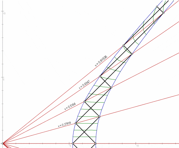

Here is a small "derivation" of the ratio of the clock rates being proportional to the ratio (R+L)/R.
The velocity of a clock on the rocket after proper time T is given as:
v = c - tanh(aT/c)
This can be rearranged to:
T = atanh(c-v)*c/a
Since the acceleration is equal to c^2/r this becomes:
T = atanh(c-v)*r/c
The ratio of the clock rates of two clocks at r1 and r2 respectively is then given by:
\frac{T_2}{T_1} = \frac{ atanh(c-v_2)*r_2/c}{atanh(c-v_1)*r_1/c}
In any given MCIRF, v is equal for all clocks at rest in that MCIRF, from the point of view of any other inertial reference frame, so we can assume v1 = v2 and can conclude:
\frac{T_2}{T_1} = \frac{r_2}{r_1} = \frac{r_1+L}{r_1}
This is how more time elapses (from launch) on the front clock relative to the rear clock as seen in any MCIRF and is also a measure of the constant redshift seen by an observer at r2 of a signal at r1.

Let me try to explain what I meant by the two causes for the discrepancy between the two clocks.
Let e1 be some event taking place at the rear clock. Let T1 be the time on that clock at that event.
Let e2 be some event taking place at the front clock that is simultaneous with e1, according to the launch frame. Let T2 be the time on that clock at that event.
Let e3 be some event taking place at the front clock that is simultaneous with e1, according to the instantaneous inertial reference frame of the rocket. Let T3 be the time on that clock at that event.
Let δT1 = T2 - T1
Let δT2 = T3 - T2
δT1 is completely due to length contraction; the front travels less than the rear, and so experiences less time dilation.
δT2 is an additional effect due to relativity of simultaneity.
In the instantaneous rest frame of the rocket, the discrepancy between the times on the two clocks is the sum of the two δs. What I've been saying is that soon after launch, δT2 is much bigger than δT1. Long after launch, δT1 eventually becomes much bigger than δT2. (The latter approaches a maximum value of L/c). In the accelerated reference frame of the rocket itself, the only relevant number is the sum of the two, which grows steadily at a constant rate.

I think it is interesting to expand on this relation T2/T1 = R2/R1 (which appears to be an exact result) by comparing it to the gravitational time dilation in the Schwarzschild metric.
First the time dilation ratio in the Born rigid acceleration case, as a function of constant proper acceleration is given by:
\frac{T_2}{T_1} = \frac{r_2}{r_1} = \frac{a_1}{a_2}
In the Schwarzschild metric the time dilation ratio of two stationary clocks in the field is given by:
\frac{T_2}{T_1} = \frac{\sqrt{1-2GM/(r_2c^2)}}{\sqrt{1-2GM/(r_1c^2)}}
and when we express this in terms of proper acceleration it becomes:
\frac{T_2}{T_1} = \sqrt{\frac{(c^2-2a_2r_2)}{(c^2-2a_1 r_1)}}
This appears to be very different to the Born rigid acceleration case with possibly a poor equivalence principle correlation, but maybe I am missing a gamma cubed factor in there somewhere between proper acceleration and coordinate acceleration. Any ideas?

I haven't yet grokked the significance of this fact, but I recently discovered (I'm sure it's already well-known, but I didn't know it) an interesting characterization of constant proper acceleration.
First, we pick a launch frame F, and set up an infinite collection of inertial frames, all related by the Lorentz transformation. For every possible value v, there is a corresponding frame Fv with coordinates xv, tv defined by:
xv = (x - vt)/√(1-(v/c)2)
tv = (t - vx/c2)/√(1-(v/c)2)
where x and t are the coordinates for frame F.
Now, suppose we have a rocket and we want (for whatever reason) to accelerate in such a way that:
We are momentarily at rest in frame F at time t=0.
For every possible value of v, we come to rest in frame Fv at time tv = 0.
So we're traveling in such a way that the "local" time is always t=0. It's sort of like traveling west so that it takes you 1 hour to pass through a time zone, so you're always entering a time zone at 12:00.
I can't think of any good reason to want to travel this way, but the interesting fact is that if you travel this way, you will be undergoing constant proper acceleration. This gives a more direct route to the equations for proper acceleration (the usual way requires knowing how acceleration transforms, and also knowing how to integrate hyperbolic trigonometric functions).
If we want to come to rest in frame Fv at time tv = 0, then using the Lorentz transformations, we find:
In order for tv to be zero, we need
t - vx/c2 = 0
Now we can write this (multiplying by -1/2):
d/dt (-1/2 t2 + 1/2 x2/c2) = 0
which has the solution
x2 - (ct)2 = R2
where R = some constant of integration. This is hyperbolic motion.
  • #64

In fact it's even weirder than that. Consider the entire worldlines of the two clocks; I'll write their equations in the "launch frame" as follows:
Rear clock: x^2 - t^2 = R^2
Front clock: x^2 - t^2 = (R + L)^2
Now draw any straight line through the origin, in the "launch frame", t = vx, where v >= 0. This is either a horizontal line (for v = 0) or a line sloping up and to the right at less than 45 degrees (for v > 0). Call the event where the line intersects the rear clock's worldline Rv, and the event where the line intersects the front clock's worldline Fv. Then all of the following are true:
(1) For any v, the line t = vx is a "line of simultaneity" in the instantaneous rest frame of the rear clock at Rv *and* of the front clock at Fv. Therefore, Rv and Fv are simultaneous as seen by both the front and the rear clocks.
(2) For any v, relative to the launch frame, the rear clock at Rv and the front clock at Fv are both moving at velocity v. Therefore, the front and rear clocks both see each other as at mutual rest at these events, and they both have the same "time dilation" factor at these events (because of the clock postulate).
(3) For any v, the proper time experienced by the front clock between F0 and Fv is greater, by the ratio (R+L)/R, than the proper time experienced by the rear clock between R0 and Rv.
So we have two clocks, which remain a constant distance apart at mutual rest, and have the same "time dilation factor" at any pair of corresponding events, and yet experience different proper times between corresponding events. I realize all this is true; I just point it out to explain why one has to be careful using the term "clock rate" without more explanation. Many people will think "time dilation factor", as in 1/sqrt(1 - v^2), when they see "clock rate" (after all, that's what I initially thought when I saw it), but that's not what you mean by the term. In particular, I think this may be one source of confusion in some of Austin0's posts.

Just to summarise, the various formulas written down by Dalespam, stevendaryl and myself for the relative red shift of clock rates on board the accelerating rocket, as measured by observers on board the accelerating rocket are all equivalent, i.e.:
\frac{\Delta\tau_2}{\Delta\tau_1} = (1+g_1L/c^2) = \frac{R_2}{R_1} = \frac{g_1}{g_2}
To the accelerated observers on board the rocket, the clocks remain at constant distance from each other, so from their point of view, none of the observed red shift is due to classical Doppler shift caused by relative velocities.

  • #86
Austin0 said:
i am not sure if this actually tracks. If the signals are simultaneous in the emission MCIRF it appears unlikely the reception ,in a frame which would be many frames and spatial distance removed, would be simultaneous. I will have to work on this.
It does track. See the attached chart showing two rockets with Born rigid acceleration. Each time signals (black diagonal lines) are emitted simultaneously in one MCIRF, they are received simultaneously in a subsequent MCIRF. In the chart green curves represent equal proper time for the rocket clocks, red lines represent lines of equal velocity relative to the LF (or subsequent MCIRFs) and the blue lines represent the worldlines of the rockets in the LF. Note the constant nature of the redshift. Signals sent every 3 ticks from the rear rocket are received every 4 ticks by the leading rocket.
Austin0 said:
even if your assumption is correct and the reception is simultaneous wrt the MCIRF how does this imply no velocity dilation?? by definition there is no motion relative to the MCIRF's so any calculation based on the MCIRF couldn't reveal relative velocity between front and back.
You have the reasoning reversed. The MCIRFs reveal that there is no relative velocity in the reference frames of the accelerating rockets. You are right that simultaneously at given instant (other than t=0) in the LF, the velocities of the front and rear rockets are different, but this simultaneity does not apply to the accelerating reference frame. We can for example show that if there is no length contraction and the rockets are accelerating identically in the LF, that differential time dilation is still occurring in the rocket reference frame.
Austin0 said:
When you say here the observer in the LF do you mean the initial launch frame or the current mCIRF
Here I meant LF, as in pick one MCIRF and stick with it, rather than keep switching to subsequent MCIRFs.
Austin0 said:
,,,,earlier you were referring to MCIrfs as LF
I just meant you could pick any arbitrary MCIRF as a LF. There is nothing particularly special about the LF. The rockets are still accelerating even in the LF.
Austin0 said:
In any case Doppler shift is as you say ,apparent dilation, so not really relevant
This is the bizarre aspect. The inertial observer attributes the redshift to classical Doppler shift due to velocity differential between emission and reception and yet the time dilation observed by the accelerating observers is real (as in physical) and an observer in the rear rocket really ages slower than an observer in the front rocket.
Austin0 said:
the question was why take an approach which had these problems and the inherent ambiguity of the result due to these problems.??
.. because nature does not give us much choice and there is no natural way to have synchronised clocks and static coordinate system in an accelerating reference frame or in a gravitational field.
Austin0 said:
well I have to disagree here. Simply scaling the clocks does not make it an inertial frame.
It is still an accelerating system.
Yes, it is still an accelerating system and I never claimed to make it an inertial reference frame. I only claimed it gave us a way to have a sensible coordinate system and a way to synchronise clocks that gives a static reference system with coordinate axes that are not changing over time. Can you suggest another way to synchronise clocks that are running at different rates?
Austin0 said:
Even disregarding the acceleration/velocity differential, a synchronization which works for one velocity cannot work for other different velocities. Yeah?? How could it?
It does work for other velocities. Have another look at the posted chart. The rear rocket sends signals every 3 ticks and the front rocket receives those signals every 4 ticks, consistently even as the relative rocket velocities constantly change over time. If we speed up the rear clock by a factor of 4/3 then the front observer will see the rear clock ticking at the same rate as his own clock for all time.
Austin0 said:
Also the measurement points could be widely separated say 0.7c and 0.8c
More and more i suspect that the velocity dilation would be insignificant and might possibly agree with the Rindler predictions. I.e. would not increase with greater velocities. The acceleration magnitudes you used were totally unrealistic. The back of the rocket quickly passing the front and leaving it in the dust ;-) so I am still unsure.
thanks
Again, if you look at the attached chart you see that the front rocket sends a signal when the rocket velocities in the LF are approximately 0.69c and the rear rocket receives that signal when the rocket velocities are approximately 0.81c in the LF and there are no problems with the rear rocket overtaking the front rocket. (Another curious aspect is that a light signal sent from left of the origin can never catch up with the accelerating rockets, even though they never attain light speed. That should bake your noodle! :devil: ).
P.S. I think Peter has a pretty good handle on it all in post #81.
