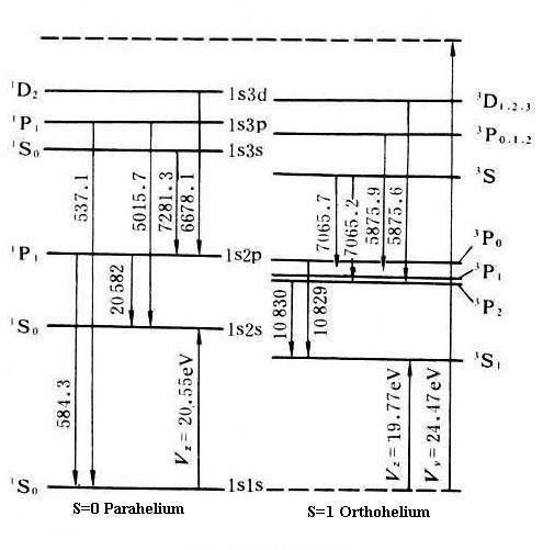

For S=0 parahelium, 1s2p-1s2s transition is allowed, but why there is no transition between 1s3p-1s3s? I think the only difference for the electron configurations is principal quantum number. The selection rules applying for 1s2p-1s2s can also be applied to 1s3p-1s3s. In other words, there is no selection rule to forbid the 1s3p-1s3s transition.
I think that it should be allowed. The chart is showing observed lines. What wavelength/frequency would the 1s3p-1s3s transition be? It may be that the chart is showing prominenet lines in a particular wavelength region. The one you are looking for might lie outside of this window.
This website shows the transition on there energy level diagram: http://hyperphysics.phy-astr.gsu.edu/hbase/quantum/helium.html

Thanks for your reply. Your idea currently is only reasonable explanation for the missing transition though I still expect more details. BTW, graph in the link clearly shows no transition between 1s3p-1s3s.

Whoops. You are correct, I mistook the 3p-2s for the one you were asking about.
Here is a better source: http://www.nist.gov/srd/upload/jpcrd382009565p.pdf
This source lists the transition (#73 in the list for He, on page 618) as being 1,344 cm^-1 -- in the infrared region.
