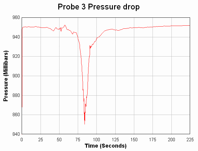

Here is a chart showing the pressure drop within a strong tornado.
Anyways, onto my question, I've tried using the formula provided in a previous thread, but it's a bit confusing, so I was wondering, given a model house of 50 feet long, and 20 feet high, (forgive me if I'm totally off on the size of average homes, I'm just guessing on search results from Google), what would the PSI be on the outside walls given a wind gust of 120MPH?

Thanks for the meteorology lesson! When I used to work in nuclear power plant design, we used as I recall a tornado wind of 300 mph over a 70 foot length, and tapering down to lesser value on either side of that length! I guess this would be an F5 tornado? I'm not sure for what forces homes are designed...I think for several feet of average density snow on roofs, and I'm not sure about winds. There are also pressure drops and uplift to consider. But as for your question, the formula I use for wind forces is psf = 0.00256V2 times a shape factor, where V is in mph, and the shape factor is 1.6 for a flat surface. Thus a 120 mph wind has a pressure against a flat surface of (.00256))(120)(120)(1.6) = nearly 60 psf, or about 60,000 pounds total on a 20 X 50 foot wall. This formula comes from the drag force equation for average density air. There are also gustfactors and height factors to consider.
