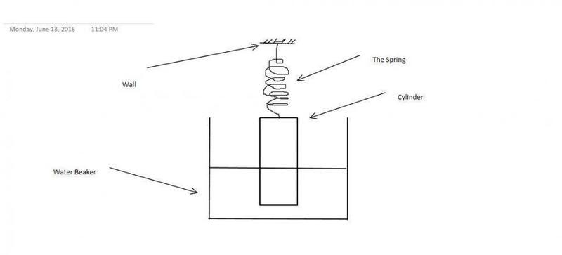

As in the given picture, the cylinder is drowned (not completely drowned as in partially drowned) in water. The cylinder is attached with a spring which has the spring constant of 200 N/m. The spring has attached to a unmovable point in the ceiling. The weight of the cylinder is 5 kg and the weight of the spring is inconsiderate. If the cylinder pulled slightly down then will there be a simple harmonic motion and if so what is the Period?
Important note:
The height of the cylinder is not given.
The density of the cylinder is also not given.
The density of the water is 1000 kg/m^3.

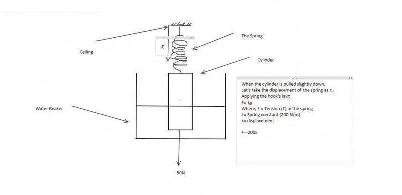

The hook's law -> F= -kx where F=force
k= the spring constant
x= is the displacement
The cylinder is moving in accelerated motion. Let's take the acceleration as a.
Applying the Newton's Law:
F=ma regarding upward motion
Where,
F=T-50+U
ma= 5a
Where T= Tension
U= Up thrust
Hence:
T-50+U=5a
-200x-50+U=5a
U=Vdg
Where V= Volume of the cylinder under water
d= Density of the cylinder
g= gravitation acceleration
This is where I am stuck. I cannot identify the volume of the cylinder under water since it is changing during the motion. What should I do next...?
Are you not told the radius of the cylinder?
Didn't I mention it?
The radius is 6 cm

The problem was solved... The radius of the beaker does not matter nor the height of the cylinder and the density of it.
The method to find the answer is first we have to draw a step of equilibrium of the cylinder.
Then we have to note that the submerged volume of cylinder is h at the equilibrium stage. Whereas the displacement of the spring is noted as c.
Then we can see
F = -kx
F = T
x = c
T = -kc
U = Ahdg
Considering equilibrium of the cylinder:
F= ma
T + U -mg = 0
-kc + Ahdg -mg =0
Then we go to the step where we pull the cylinder for x distance
Then,
Tx = -k (c+x)
F= ma for up
Tx + Ux - mg = ma
Ux = A(h+x)dg
-k (c+x) + A(h+x)dg - mg = ma
-kc -kx + Ahdg +Axdg -mg =ma
-kx + Axdg = ma
The final equation is
a = -(Adg - k)/m * x
Hence the ω2 = (Adg - k)/m
Then ω2 = 2π/t
A = π*0.062 m2 = 0.0036π m2
d = 1000 kgm-3
g = 10 ms-2
k = 200 Nm-1
m = 5 kg
Then t (period of the SHM) can be found...
Thanks...
