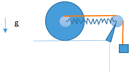

A rope is wound around the axis orthogonal to a disk of mass ##M## and radius ##R## and there is a mass ##m## hanging from this rope as shown in the figure. The disk rests on a horizontal plane and connected to its center there is a spring which has its other second end fixed on a pulley.
(a) Determine the deformation of the spring at equilibrium.
(b) At a certain instant the mass ##m## is slightly lowered from the equilibrium position and then released. Determine the period of the oscillations that are caused by knowing that the disk rolls without slipping.
Assume ##M, R, r, k, m, m_{pulley}, r_{pulley} = r## all known.
##\vec{F}=m\vec{a},\ \tau=I\alpha,\ a=R\alpha##
(a) By setting up a coordinate system with the x-axis pointing to the right and the y-axis pointing downward we have ##\begin{cases}-kx_{eq}+T_1+F_{s}=0\\ -RF_{s}+rT_1=0\\ r_p (T_2-T_1)=0\\ -T_2+mg=0\end{cases}\Rightarrow x_{eq}=\frac{mg}{k}\left(1+\frac{r}{R}\right)## which coincides with the solution given.
(b) If we denote by ##a_{D}## is the the acceleration of the center of mass of the disk, I think the the goal should then be to obtain an equation of the form ##a_{D}=\frac{\text{const}\times K}{\text{some combination of the masses}}(x-x_{eq})## so that ##T=\frac{2\pi}{\omega}## where ##\omega=\sqrt{\frac{\text{const}\times K}{\text{some combination of the masses}}}##. I have thus set up the following system:
##\begin{cases}-kx_{eq}+T_1+F_{s}=Ma_D\\ -RF_{s}+rT_1=I_D \frac{a_D}{R}\\ r_p (T_2-T_1)=I_{pulley}\alpha_{pulley}=I_{pulley}\frac{a_D}{r}\\ -T_2+mg=ma_D\end{cases}##
The problem is that the solution given says that in equation (3) the RHS should be ##\frac{I_{pulley}}{r_{pulley}}\frac{a_D}{R}(r+R)## and in equation (4) the RHS should be ##m\frac{a_D}{R}(r+R)## but I haven't been able to figure out why that is.
If the rope is ideal, shouldn't mass ##m## have the same acceleration as the disk?
Thanks

lorenz0 said:
If the rope is ideal, shouldn't mass m have the same acceleration as the disk?
No, why would it? Think about what is said in the problem statement about how the disk is attached to the rope.
Likes lorenz0
Thinking about it, since the rope is attached to axis of radius ##r## orthogonal to the disk, if the disk moves a distance ##x## then, since it moves without slipping it must be ##x=R\theta## where ##\theta## is the angle the disk (and also the axis) turn and so the length of the rope changes by an amount ##\Delta l=r\theta=r\frac{x}{R}## and by differentiating two times with respect to time we get the acceleration of a piece of the rope is ##a=\frac{r}{R}a_D##. Now, since the rope is ideal I think mass ##m## should move downward with the same acceleration as a piece of the rope so I get for the RHS of equation (4) ##m\frac{a_D}{R}r## which is closer, but not equal, to ##m\frac{a_D}{R}(r+R)##.
Does this make sense? How can I improve my reasoning? Thanks.

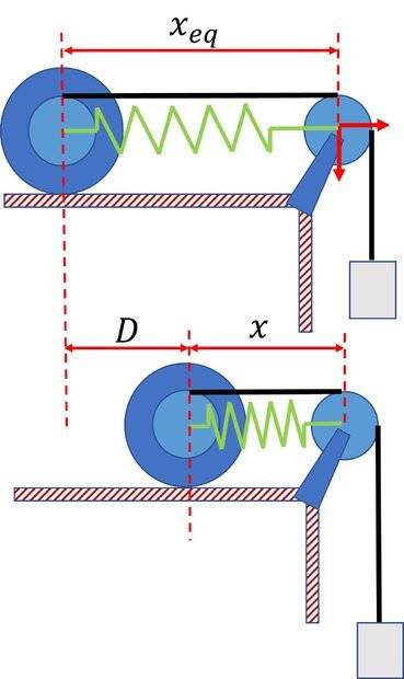

I'm still not exactly following though. Where is ##x## to be taken from? Is it the displacement from the equilibrium position or the CoM coordinate of the disk measured from the fixed pulley? Maybe I'm missing it completely. I'm sorry for being hopelessly confused about this.
Likes Delta2
Is what I'm referring to as ##D## in the diagram, what you are referring to as ##x##?

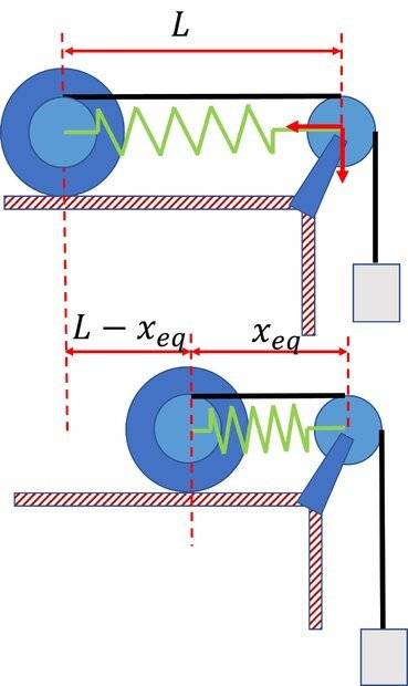

Case I: Measure horizontal positions from the center of the pulley.
With this choice position increases to the left so to the left is positive and to the right is negative.
Part (a)
System is at rest
Let ##L## be the relaxed length of the pulley. Then the force balance equation is
##k(L-x_{eq})-T_1+f_s=0##
Using the second torque balance equation, one can find ##x_{eq}## which is constant.
Part (b)
Spring is compressed additional distance D from equilibrium
##k(L-x_{eq}-D)-T_1+f_s=M_Da##
Case II: Measure horizontal positions from the left end of the relaxed spring.
With respect to case I, the origin has moved to the left by ##L##. With this choice, position increases to the right so to the right is positive and to the left is negative.
Part (a)
System is at rest
The force balance equation is
##-k(x_{eq})+T_1-f_s=0##
Part (b)
##-k(x_{eq}+D)+T_1-f_s=M_Da##
In either case the quantity that you have defined as ##x## in the figure, namely the instantaneous length of the spring does not appear. If you really insist on using ##x## as a position variable, then you must write the spring force as ##F=k(L-x)## so that it changes sign when the spring changes from being compressed (x < L) to being extended (x > L). This is equivalent to defining ##x=x_{eq}+D## in case I.
The bottom line is that the system will oscillate with the same frequency regardless of where you and I pick the origin. I favor Case II because then I don't have to worry about how long the spring is.

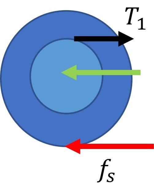

For case 1:
You have ##f_s## pointing to the left. I don't understand that. Doesn't the force of static friction have to counter the torque from the tension force ##T_1## so that the wheel doesn't slip?
This FBD seems like there has to be a net torque on the wheel?
The force of static friction is what is necessary to provide the observed acceleration. When you have to balance both forces and torques, the direction of the static friction is not always obvious. The way to proceed is to assume a direction, solve the equations for the unknowns, and see what you get for ##f_s##. SInce in the original equations ##f_s## stands for the magnitude of the friction, if this number comes out negative it means that you have chosen the direction incorrectly; if it comes out positive, it means that you you have chosen the direction correctly.
It does, doesn't it? Have you solved this problem, part (a)? If not, do it assuming that ##f_s## is as shown in the diagram and see what you get.

erobz said:
Doesn't the force of static friction have to counter the torque from the tension force T1 so that the wheel doesn't slip?
The torques would have to balance for the system to be static, but it is not a requirement for rolling contact. How do the wheels of a car get to rotate faster as the car accelerates without skidding?
kuruman said:
It does, doesn't it? Have you solved this problem, part (a)? If not, do it assuming that fs is as shown in the diagram and see what you get.
$$ k \left( L - x_{eq} \right) - T_1 + f_s = 0 \tag{1} $$
For the sum of the torques: ## \circlearrowright^+##
$$ Rf_s + rT_1 = 0 \implies f_s = -\frac{r}{R}T_1 \tag{2}$$
Since the system is static ## T_1 = mg##
$$ f_s = -\frac{r}{R}mg \tag{3} $$
Subbing back into ##(3) \to (1)##
$$ k \left( L - x_{eq} \right) - mg -\frac{r}{R}mg = 0 \implies x_{eq} = L - \frac{mg}{k} \left( 1 + \frac{r}{R}\right)$$
Which is consistent with expectations.
##(3)## is saying that the ##f_s## is opposite the assumed convention?
I tricked myself into believing I understood this somehow, and I clearly don't. So I'm just going to answer your question. They must have a net torque on them to accelerate. I can't figure out what that exactly implies for the force of static friction and the fact that they don't slip relative to the road.
I'm thinking if we took torques about the point of application of the static friction force ##P## the force of static friction ##f_s## will have no moment arm, and thus apply no torque. However, letting/forcing the wheel to slip...still no moment arm for the kinetic friction ##f_k## either in that perspective...so that is probably not the proper treatment.
A common misconception is that "friction always opposes motion". That is true when surfaces in contact slide past each other but not necessarily true when they are at rest with respect to each other. Take the simple act of starting to walk from rest. Clearly, you cannot do that on a perfectly frictionless surface. What external force provides the forward horizontal acceleration that changes your velocity from zero to non-zero? Hint: It cannot be gravity because it acts along the vertical. What is left?
The bottom line, consistent with Newton's laws, is that the force of static friction is whatever is needed to provide the observed acceleration.
Likes Delta2
I'm not conflicted about letting the laws decide the direction, I'm conflicted about the magnitude of ##f_s##.
