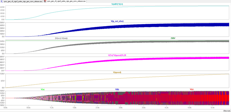

png file plot shows from top to bottom :
-Field losses
-net ouput (load) power - in watts, (do not be confused by the units legend)
-DC voltage (after rectifier / smoother)
-electrical power of the generator derived from electrical torque
-rotor (mechanical) speed in turns/s
-abc phase voltage waveforms
