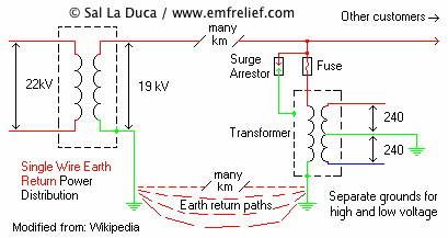

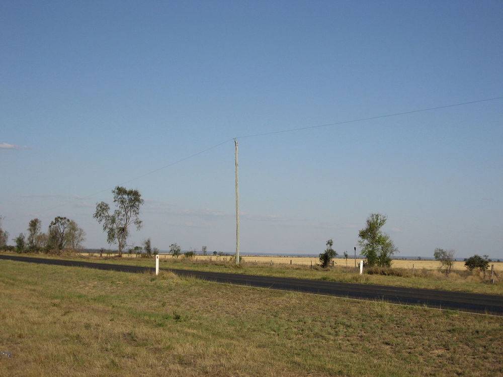

Actually you can see that ... this topic has come up in the past and I remember then talking about
SWER ( Single Wire Earth Return) systems. Very common in rural areas over longer distances very economical as there is only one conductor to pay for.
my old home country of New Zealand have a lot of them.
an example from somewhere around the world ...

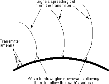

Sure, Ground return is really just a current electricity loop with a lossy ground wire.
Single wire transmission is a EM surface wave propagation mode. It's something we used at shortwave across a conductive plane like the surface of the earth. The common term is a ``ground wave'' with the Earth's surface as the 'single' conductor for the surface wave component of the received signal.
https://www.electronics-notes.com/articles/antennas-propagation/ground-wave/basics-tutorial.php

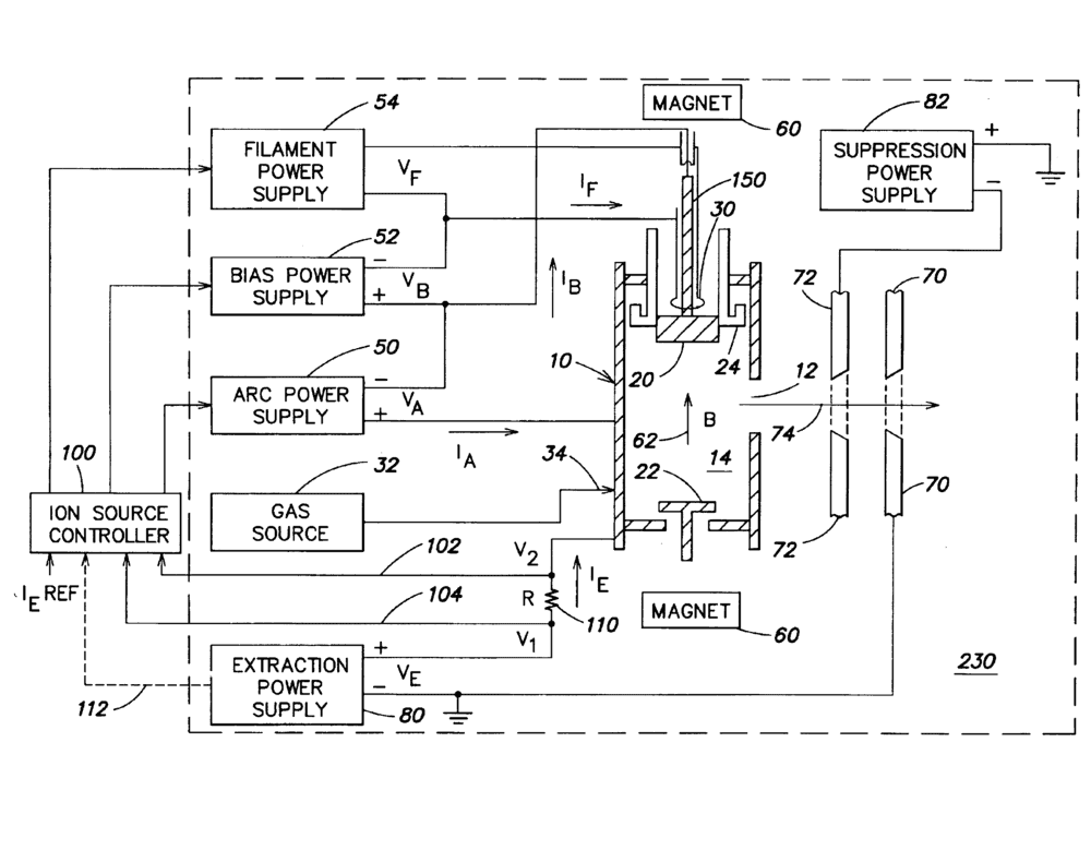

As I do research on the topics above, a quick and related followup on the question. What is it meant by "return circuit"? I used to think it's simply return of electrons, but I guess it's more of a charge path which might not necessary mean electrons. Is that right?
In most simple cases the "return circuit" is a current convention about how we reference potentials between points instead of a physical direction for charge to move back to a source.
A slightly complex DC example of return circuits where some charges are electrons and some are positive ions (arc supply) in a operational arc chamber.
Simple answer: Take just the simplest element such as a AA battery. No current leaves the plus terminal unless the same amount of current enters the negative terminal. (Note that electrons are minus, so electrons flow the opposite direction of current.) A battery with only one wire attached can not deliver current, not matter what the voltage. With two wires it can. The wire connected to the negative terminal we call "return".
Complex answer: You keep adding new things to your questions. Electrons are not the only way to get current, an ion or any charged particle can be the transporter.
