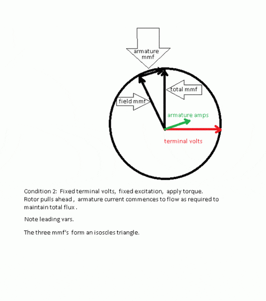

Okay i braved MSPaint and will now show my abysmal skill with it.
You were right about the hypotenuse at unity power factor. Dawing the pictures really cleared it up for me, i should have done it yesterday before posting. But it was way past bedtime as it is again now.
Hmm computer just typed something from days ago - -something going wrong here. Well let's see if i can finish this post..
The circle just represents locus of constant mmf or voltage .. helped me draw .
Machine unloaded, some base excitation and voltage. No armature current, hence no power and theoretically no torque (windage and bearings and i suppose magnetic losses in core that we'll ignore).
Machine with same excitation and same terminal volts, as we apply torque and let armature current flow however it sees fit.
Observe machine went into lead - the system delivered the excitation shortfall by supplying reactive current . Green current is ahead of voltage.
Hah ! There's my blooper ! That triangle is isoscles not right.. What was i thinking? Belay my claim about hypotenuses !
This time we applied torque but adjusted excitation to maintain vars at exactly zero.

Okay, this time there IS a right triangle because of unity power factor , amps and volts both perpendicular to total flux
I'm more than a little embarassed at my floundering around with this.
But i prefer to go back to basics and figure it out, for you see what happens when i try to remember.
Thanks for the refresher, "I needed that".
I hope this simplistic thinking is of help . With a good mental picture one can figure out the equations instead of memorizing them.
