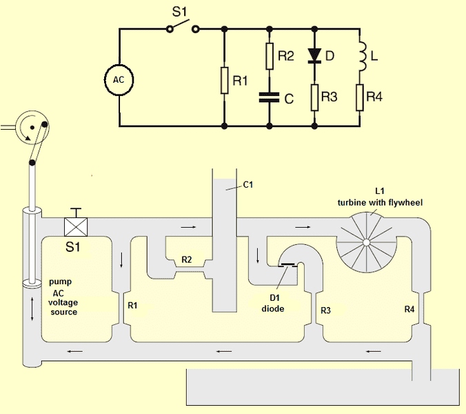

Water analogy (just for fun)
As you can see Inductor water analogy is a turbine with a flywheel. The mass of the flywheel determines the value of a inductor inductance.

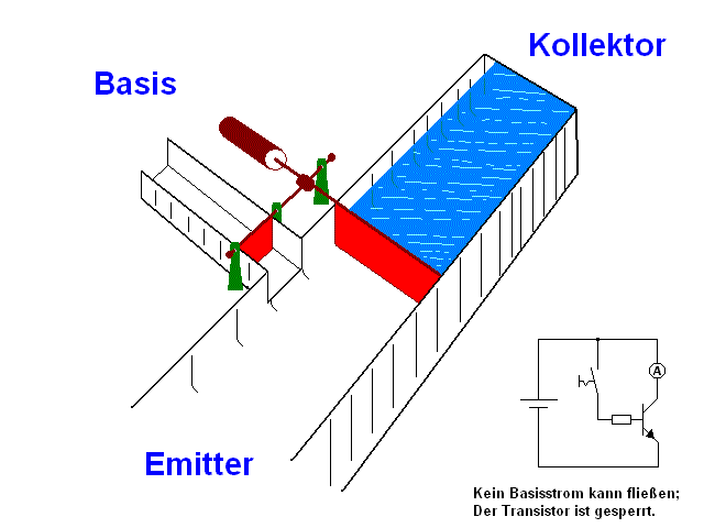

And the bipolar transistor water analogy

The surge tank is there for C1, and inertia is there in the turbine's flywheel.
Actually, my biggest objection to the water analogy is that based on the questions I see, some water analogy students never learn pressure*flow is power. They think the flow is power, and that electrons in a circuit are like little energy capsules that deliver discrete bits of energy to the destination. Even Jony130's clever water circuit does not help anyone visualize power versus time, only water flow versus time.
The whole thing is exacerbated because teaching the water analogy is often 100% verbal, when pictures are really needed to clarify. Jony130's is an example of a very clever circuit, but too difficult to explain without a picture.
