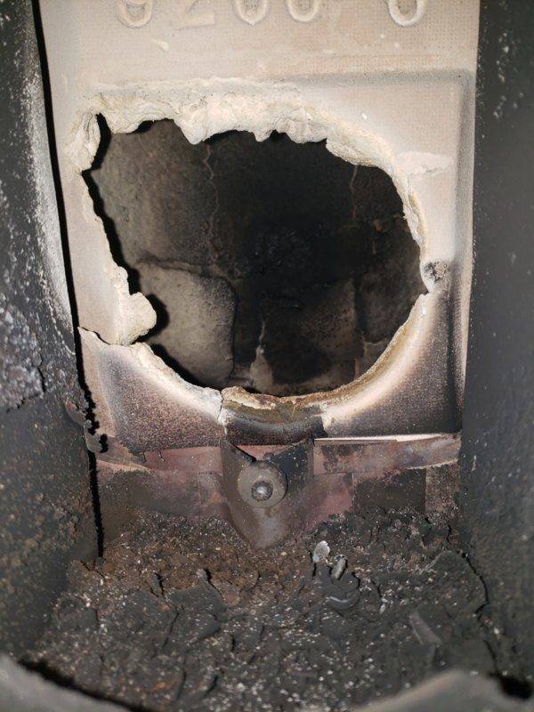

You are probably better off using a refractory material because that will maximize the temperature in the chamber by minimizing the heat that is lost through the conduction through a metal containment. It does not necessarily need to be a cylinder, it could just as well be a rectangular tube built from refractory bricks as long as adequate air flow is provided to insure complete combustion.
This was the Beckett burner damage to the oil furnace. It took hundreds of hours to degrade this bad but the rear of the combustion chamber is disintegrated finally. It still worked but I decided it's not worth keeping anymore. The waste oil spray pattern is more narrow than heating oil thus the flame constantly hits the combustion chamber at the back.
My boiler firebox is 40" long so it's more accommodating to this burner on waste oil

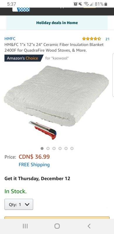

dlgoff said:
I was thinking of lining your chamber with ceramic sheets.
I was literally just thinking almost the same thing 🤣
Likes dlgoff
I've never worked with ceramic fiber blanket, I assume I could make a metal frame to hold it because the heat would be primarily contained on the one side
Just a note: Keep in mind that the ceramic blankets are an insulator that will reduce but not eliminate the heat transfer to the surrounding metal and what is OK for a wood fireplace may not cut it for your full combustion oil spray condition; and, may also become oil saturated from the oil spray resulting in burning within the fiber blanket.
Edit: At the same time there is also a ceramic fiber board that may work instead, see below:
https://www.amazon.com/dp/B07QBPVMJZ/?tag=pfamazon01-20
A warning that I ran across looking at the ceramic wool products is that the fibers can come loose and become an inhalation hazard. This might be more of a hazard for using with a foundry more than a firebox use, but there are products to apply to the fiber mat to secure the fibers from what I've read so anyone playing with ceramic wool should probably look into that before deciding if they require it. I think I like the ceramic wool more than the ceramic plate or solid board, because it seems like it could be easily cut and bent etc and shaped to fit many uses.

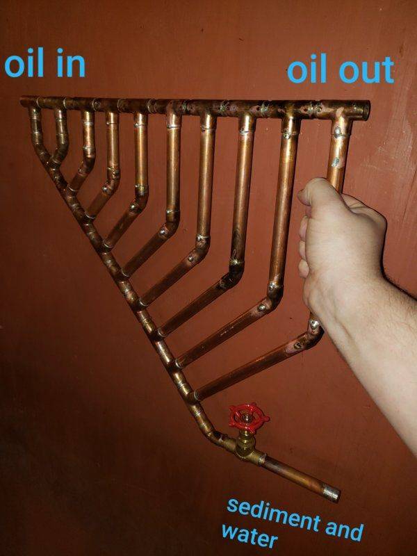

This is what I built, inline fuel settling contraption. To help clean waste oil before the main filter on the burner.
