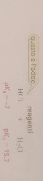

Last doubt.
If we had an acid-base reaction that takes place between two species of which we do not know which acts as a base and which as an acid, how can we predict from which species to which species the proton travels if it is not correct to use the relative pKa?
PS. My book (Bruice) uses pKa to determine who acts as acid. But actually It doesn't make much sense if theese pKa refer to different reactions.
