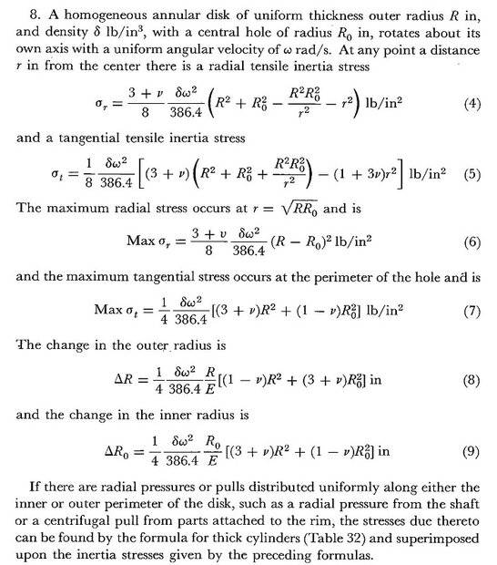

Hey folks,
I've been looking around but can't piece this together as there are more than one equation and variable to take into account.
My situation - I have a pmma material disc on an axis , the center hole (axis hole) is 20mm wide so a radius of 10mm, while the outer edge is at a radius of 194mm from the center. The disc is 15mm thick and another one is 10mm thick.
I calculated from the given weight per square meter that my discs should weigh approximately 2kg for the 15mm thick disc and 1.4kg for the 10mm thick disc.
Given this information can I arrive at a safe RPM zone to know what is the tensile stress at certain RPM?
I do have a metal shield but still I don't like sudden surprises.
I'm running the discs at about 1200 RPM.
I'm not familiar with PMMA - is it a brittle material? If so, the surface finish of the ID and OD is critical. Those surfaces should be smooth, or even polished. Brittle materials are very subject to sudden failure that can start with a microscopic crack. And yes on the metal shield. Brittle materials need large safety factors because they are very sensitive to surface finish. Also, they tend to fail suddenly.
This excerpt from Formulas for Stress and Strain, 5th Edition, by Roark and Young, tells how to calculate the stresses in a spinning disk with a center hole:
The symbol ##\nu## is Poisson's ratio.

I was bit lazy and tired given it's sunday evening and I found a nice page with an online calculator ,
https://amesweb.info/StructuralAnalysisBeams/Stresses-Rotating-Rings.aspx
I entered all the ratios specific to PMMA and my RPM count of 1200, it gave me very low numbers. The tensile strength of cast PMMA is from 30 to 50 MPa according to google, so for 1200 RPM it shows the tensile stress near the center is only 0.5 MPa , so technically I'm far within the safe area.
I input 10k RPM just for fun and it still was only around 20 MPa so technically ok.
I found that crazy somewhat that such a hard plastic can take such abuse and still seems to stand.
