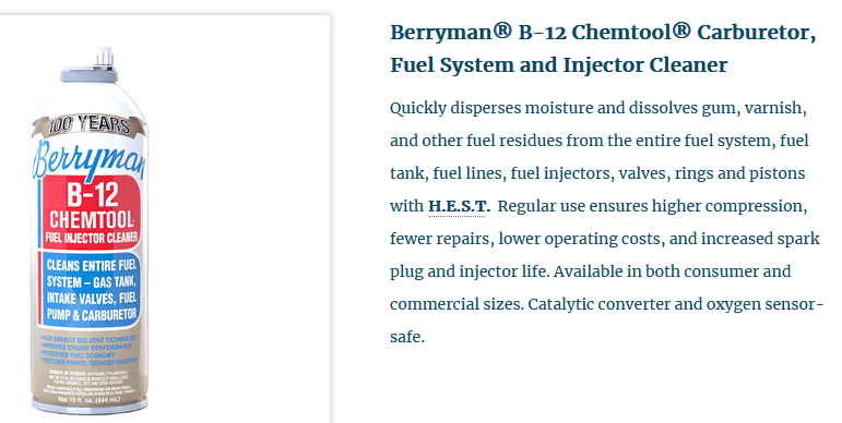

I'm looking at berryman's b12 chemtool.
It is used with success to remove carbon deposit on piston rings, breaking them free from sticky sludge, and thereby lessen oil consumption.
I can not get the product where I live. So I wonder if I could copy the effect by identifying the most lightly active ingredients and make a blend?
The content is and the numbers are percent, I think volume percent.
Toluene 40 - 50
Acetone 20 - 25
Methanol 20 - 25
Methyl Ethyl Ketone 1 - 5
2-Butoxyethanol 1 - 5
2-Propanol 1 - 5
Toluene is a constituent in gasoline. I'm not sure, but I think it might act more as a carrier for the active ingredients and basically safe for the combustion chamber where you pour it down the spark plug holes. If so could I use gasoline instead?
I wonder about the last 3 ingredients, do you think they have a big impact if omitted?
Why I ask is because they are hard to get.
I know that gunsmiths use 2-butanone (MEK) to clean carbon deposits in guns.

With my Mentor superpowers, I'm able to see your location, and it's not like you are in the middle of a desert or something. When you ask about similar cleaners at your local auto parts store, what do they recommend?
https://www.berrymanproducts.com/pr...-carburetor-fuel-system-and-injector-cleaner/
MSDS: https://www.berrymanproducts.com/assets/1AA-1-aerosol-0110-0117-0120-SDS-R06.pdf
Thank you :)
There have been multiple discussions about getting it and alternatives on forums. There is no product in Europe that is comparable according to the posts. It is only available in USA. Since toluene, methanol with 5% nitromethane and acetone is redaly available I wanted to get an opinion on the viability of using a blend of these. I omitted the nitromethane since it will be low concentrations reading more about it, it is used in solvents for ca-glues and might not be good if it reaches the hydrocarbons in the piston rings. On the other hand it is low concentrations and I will change the oil after the procedure.

I will try to free up the carbon/polymerized oils on the rings using the mixture with methanol, acetone and toluene.

I mixed paint thinner (toluene) and RC-fuel (methanol) with acetone at a ratio of 120ml paint thinner, 45ml RC-fuel, 24ml acetone (there where some in the paint thinner). To get the approximate ratio of Berryman's.
I poured it down the spark plug holes in the the beginning of the compression stroke, fitted the spark plug and compressed. I let it sit with static pistons for 48h and top up multiple times. Then sucked it up with a syringe fitted to a longer small diameter hose. The hose length will determine how much you can extract from the cylinder. Let the solution only enter the hose not the syringe because the solution will render the syringe broken.
What was not so good.
A plastic sensor in the sump got affected, probably because it was partly melted by the solution. After running the car some time it started working again.
There where not much lubrication during the hydrolock compressions. I might have marred the bearings.
If I would do it again I would have kept the oil in the motor, it would have contaminated the motor oil but I would have done an oil change afterwards anyways. That would have negated the possible marring and the effect on the sensor.
What was good.
Afterwards the car felt like a different beast entirely. It ran so much better.
It had torque in low rpm that it did not have before and was much more agile.
I would definitely do it again if I had the same problem again.
I would have just poured in the solution and perhaps agitated the crank a little and let it sit and top up. When agitating some claims the timing belt can jump a notch if you do it in the opposite direction of how the motor spins. For me nothing happened but it might be best not to. Not try to hydrolock it with the solution to force it past the piston rings. Perhaps let it sit for longer since less mechanical agitation was applied.
A note. The car did not want to start afterwards. I had to connect it with starter cables to a second battery to let it rinse out the solution before it started again. Even if I sucked most of solution out. It took quite a lot of Ah from the both batteries. If anyone tries this have two batteries that are fully charged at hand. I let it rev for between 2000-3000 rpm for 10 minutes to clean out everything after start, then I did an oil change. The oil that came out was smelling like the solution.
