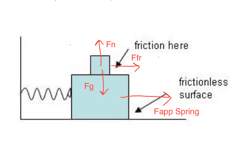

The figure shows a 1.0 kg mass riding on top of a 5.0 kg mass which is attached
to a spring. The 5.0 kg mass oscillates on a frictionless surface, and the spring constant
is k = 50 N/m. There is friction between the upper block and the lower block, and the
coefficient of static friction is 0.50.
a) As the amplitude of the motion is increased, there is a maximum amplitude for
which the upper block does not slip on the lower block. Explain why, and calculate
this amplitude.
kx = Ffr
Can someone explain to me - possibly through a FBD, why, when figuring out question a), the Ffr between the 2 blocks is 6.0kg * 9.8 * .50?
Why would it not be the normal force of the top box? Simply 1 * 9.8 * .5?
How does the larger bottom block exert a normal force up and why does this not happen with, let's say an object lying on the Earth (we don't include the mass of the earth)
Thanks.

After thinking about it some more, I am starting to really get lost.
Does the attached diagram look right?
Turns out i missed fg and fn of lower block. So pretend I have those in
The diagram is right. Don't worry about vertical forces on the lower block - they will just balance out.

If the spring force and the frictional force on the lower box were in balance then the lower box would not accelerate. It does accelerate. The frictional force is therefore allowed to be less than the spring force.
The equation of relevance is ΣF=ma. Write out that equation for each box, on the assumption that there is no slipping.

Top box = 1.0 * a = Ffr
Bottom box = 5.0 * a = kx
Sorry but I am not seeing the relationship between the two (+ i don't think my fnet are right..)
You are missing a horizontal force. Remember - bodies exert equal and opposite forces on each other.
Ok, so since there is no friction on the bottom, the other surface the lower block is in contact with is the upper block.
So the Ffr between the 2 blocks also applies to the bottom box?
5.0 * a = kx +(?) ffr?
dantechiesa said:
+(?) ffr?
Equal and opposite
haruspex said:
Equal and opposite
Presuming you mean kx - Ffr = ma.
DOes that mean we now need to find a in order to find x?
Secondly, can you explain why its like that?
Thank you!
Yes, and your equation for the top box tells you the value of a.
The coefficient of friction sets a limit on the acceleration that can be achieved by the top box. If the lower box exceeds that then slipping will occur.
Likes dantechiesa
It all worked,
Thanks for sticking it out!
