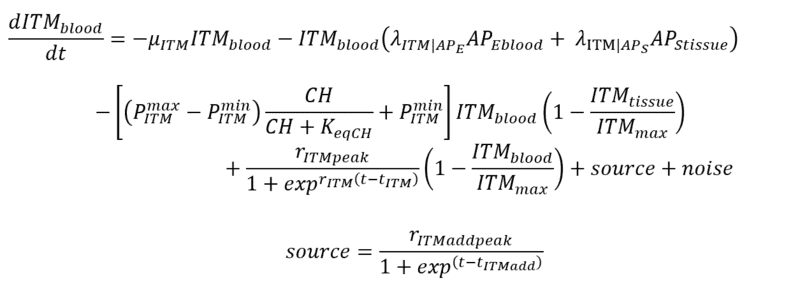

I have 14 coupled ordinary differential equations. I am trying to increase the concentration of one of the ODEs by adding a sinusoidal equation that is at the same time "noisy". This noise I introduce follows a gaussian distribution with mean 0 and sigma that I vary in several experiments. I have not tried calculating for an analytical solution (not sure if even possible) but only used Python to solve the system. I don't know if I am doing it right. Any help is appreciated.
The Coupled ODE Model
Below are my coupled differential equations, where the only variable I try to meddle with is the ITMblood. The motivation here is if I try to increase ITMblood (in the next section I will show how I do it), at some concentration of ITMblood (most likely a very huge one) , the system below "collapses." That is, some of the concentrations just flattens out.
Introducing Noise to ITMblood
This is just a naive method that I am doing. So I just add a "source" of this ITMblood that follows a sinusoidal function which plateaus at rITMaddpeak and somehow starts "late" controlled by tITMadd. Then I add "noise" that simply follows a gaussian distribution with mu = 0 and sigma that I vary as part of my experiments.
Python Library Used to Solve the Equations
scipy.integrate.odeint
note: I have tried an existing library (sdeint) specifically designed for SDEs but for some reason, the solver just can't handle the system/blows up, even when I have not added noise yet (used this as sanity check).
Am I doing this right? Does this method of introducing noise make sense? Thank you very much! I can upload my notebooks if necessary.

Holy equation, batman! That's a lot of equations to process :oldbiggrin:
If you don't mind, I'm going to arbitrarily cut out some of your variables and make a toy model that will be easier for myself and other folks to analyze. If I end up cutting out something that's extremely relevant, please speak up.
How about a two-equation model: $$\frac{dITM_{blood}}{dt} = -\mu_{ITM} dITM_{blood} - \lambda_{ITM | AP_E} AP_{Eblood} ITM_{blood} + \frac{r_{ITMpeak}}{1+\exp[r_{ITM}(t-t_{ITM})]}\left(1 - \frac{ITM_{blood}}{ITM_{max}} \right)$$ $$\frac{dAP_{Eblood}}{dt} = -\mu_{AP_E} AP_{Eblood} - \lambda_{ITM|AP_E} ITM_{blood} AP_{Eblood}$$
What I see here is that ##ITM_{blood}## will decay if there is no source function, and that ##ITM_{blood}## has some funky time-dependent behavior that asymptotic flattens out as ##ITM_{blood} \rightarrow ITM_{max}## and also flattens out asymptotically as ##r_{ITM}t \rightarrow \infty##. If you want to observe this behavior, it seems all you need is a constant source term:
$$\frac{dITM_{blood}}{dt} = -\mu_{ITM} dITM_{blood} - \lambda_{ITM | AP_E} AP_{Eblood} ITM_{blood} + \frac{r_{ITMpeak}}{1+\exp[r_{ITM}(t-t_{ITM})]}\left(1 - \frac{ITM_{blood}}{ITM_{max}} \right) + S$$ where ##S = \mu_{ITM} ITM_{max} ##. That constant source term will cause ##ITM_{blood}## to reach equilibrium at ##ITM_{max}## where you will see flattening of the funky time-dependence. I'm not sure what you hope to accomplish with the inverse exponential source you added (also, why did you call that a sinusoidal term? that part was very confusing to me and I think it's just a matter of context). It's also not clear to me what the noise term would do for you. Can you elaborate?

Go ahead! I did not want to miss out on the details, which could be important. That huge system is actually a model of the immune system. :oldbiggrin: But you're right! Trimming it down to a toy model won't hurt.
Twigg said:
What I see here is that ITMblood will decay if there is no source function
You are absolutely right! To make it comprehensible, ITM here means Inflammation Triggering Moieties or the bad things that make your immune system fire up.
Twigg said:
ITMblood has some funky time-dependent behavior that asymptotic flattens out as ITMblood→ITMmax and also flattens out asymptotically as
Yes! The sigmoidal function has an initial peak controlled by ##r_{ITMpeak}##. If the concentration of ##ITM_{blood}## closes into ##ITM_{max}##, it just stops adding up. So the following term controls the slow build up of ITMs. :woot:
$$1-\frac{ITM_{blood}}{ITM_{max}}$$
It basically means the system can only handle this much maximum concentration of ITMs.

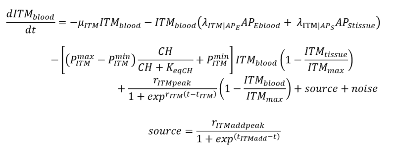

I wanted to add a source of ITMs (as this original equation/profile for ##ITM_{blood}## eventually decays). Let's just say, some medical complications happen and suddenly we have another source of those bad things (ITMs). BUT the catch is, I wanted to make it noisy to mimic a real system (as opposed to a deterministic one).
My bad! This was a typo. Let me edit it in my original post. I was referring to "sigmoidal" :nb).This is how I want to add the source term of ITMs so it won't increase linearly, and instead stop increasing at a maximum value. I hope that's clear?
So why I am adding noise? To mimic a real system! And hopefully, if the concentration of ITMs becomes critical to the system, I will see a "collapse" (I imagine this as some concentrations not going back to normal values). The noise I can "study" using early warning signals for critical transitions.

Scenario 1
Here's what it looks like if I add a continuous source of ITMs without noise.
and with noise:
So far so good.
Scenario 2
When I add a source of ITMs for a period of say 3 hours, here's what it looks like without noise. Makes sense as the concentration of ITMs go down immediately after 3 hours.
But when I add noise, I get this weird plot that does not even make sense o_O. Most times I just get random plots that break at certain points.
Sorry for brief reply. Life caught up with me.
Smells like overflow error. The y-axis on the second plot around 4E307, and the maximum allowed value of a double float is 1.7E308. Either there's a true arithmetic overflow error or your system of equations isn't stable under a white noise source (what you used).
A few things worth trying:
(1) reduce variance of the noise source by powers of 10 until the issue stops and see if that result makes sense,
(2) try pink noise instead of white noise (take fft of white noise, apply a 1/sqrt(f) filter, then ifft; alternatively I have some code you can use let me know if you want it). If this works, it means your system of equations doesn't like high frequencies or has some poles in its transfer function. You could even apply a boxcar/cutoff filter to your noise signal to narrow down the range of problematic frequencies.
(3) try starting with the 2 equation toy model and seeing if it has the same issue. If it doesn't, add equations back into the system until it does. That will tell you which degree of freedom is problematic

Really good recommendations! I'll try these and post some updates.
