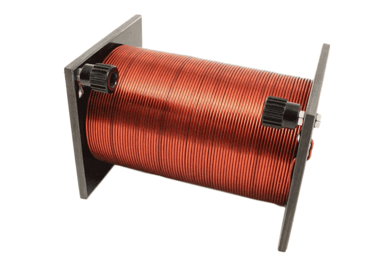

Yes, a solenoid to pull in a ferrous object (rod or ball) is an open air core coil, like the one shown below. There is no value to a core inside the coil, since you just want to have a big diverging magnetic field to attract the metal ball into the coil area.
https://www.arborsci.com/products/solenoid-air-core
20 gauge Copper wire is rated for 1.47Amps continuous and will melt around 58Amps in free air.
Since the wire will be wound in a solenoid, there will be some heat buildup in the inner layers. This may be enough to damage the insulation and cause some shorted turns. Wire with high temperature insulation is available, common hi-temp insulations are Glass cloth, Teflon and Asbestos.
Both Teflon and Asbestos have their own potential drawbacks though.
If Teflon gets hot enough to degrade, the fumes (hydrogen fluoride, carbonyl fluoride, and others) are highly toxic (https://pubchem.ncbi.nlm.nih.gov/compound/8301#section=Toxicity-Summary).
Less dangerous in small doses are Asbestos fibers released in handling that can be inhaled and eventually cause lung damage (Asbestosis).
https://www.mayoclinic.org/diseases-conditions/asbestosis/symptoms-causes/syc-20354637

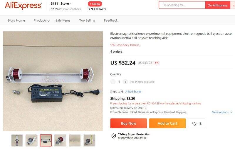

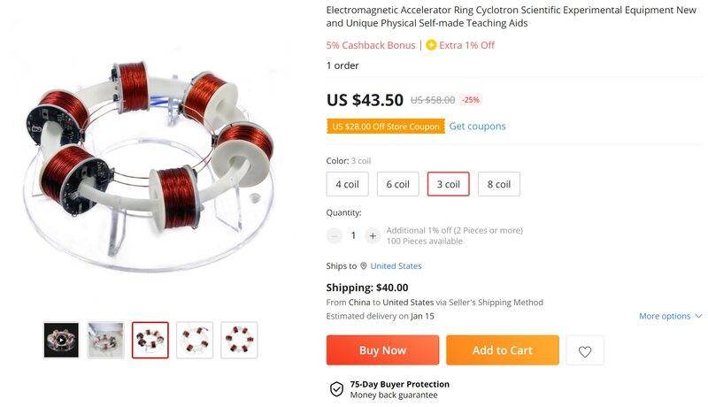

How about buying a pre-made kit to experiment with and modify to your specific use?
