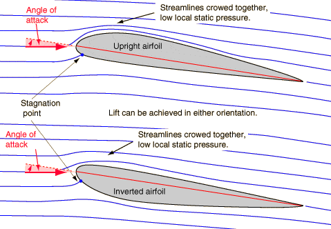

What about a very, very thin wing, just a curved plane. The air would travel the same distance over and under the wing, yet it will still produce lift.
  • #59
The travel distance doesn't matter though. In my very first post on this thread, back on page 1, I even said "the common "longer path length" explanation is completely bogus".
  • #60
A thin curved plane is just a cambered airfoil that has a poor aerodynamic shape; hence, its lifting capability is lower and its drag is higher than those of an equivalent streamlined airfoil.
The Wright brothers experimented with that shape first, but moved to more rounded leading edges, where most of the magic happens.

  • #61
Jordi H said:
What about a very, very thin wing, just a curved plane. The air would travel the same distance over and under the wing...
No, it wouldn't, just as circles of different radius's have different circumferences so too the underside and top of a thin, curved airfoil have different path lengths. The closer you get to the wing the smaller the difference may be, but there is a difference nonetheless, and the airflow attached to the wing can't be viewed in isolation. The wing disturbs/re-directs air far away from its surface.
Likes sophiecentaur
  • #62
That's a really good point -- when discussing this issue people often bring up sailboats, but if sails made good airfoils planes would have airfoils as thin as they could be made. Sailboats have thin airfoils not because they are good, but because they are easy.
Having thickness to the airfoil helps, and it takes away the "same path length" argument.
