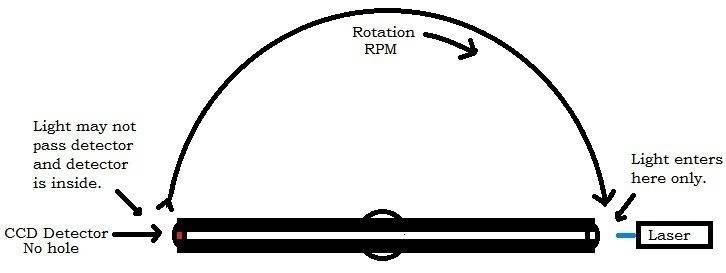

Here is a picture:
  • #114
Now looking at that picture, is it not obvious that given some rotation differing speeds of light will change the amount of light detected at the detector?
Is it not obvious that "closed paths" are not being used?

  • #116
Is it not obvious to you that the picture itself depends on the synchronization convention?
Point it out to me, because I'm lost unless your want to make some absurd classical assumptions that cannot even stand scrutiny from a purely classical perspective.
Does it require the synchronization of two separate clocks? I say no, one single clock defining RPM, and one single yardstick defining the distance light has to travel to get detected before getting blocked. If, with sufficient resolution, you measure the speed of light as it travels straight down a gravitational potential then I fully expect it to appear as though ##c > c##. Pointed up a gravitational potential I fully expect it to measure ##c < c## with the same apparatus. If you think I expect c to differ from c in an otherwise inertial frame by virtue of some medium lacking inertial effects it would be absurd.

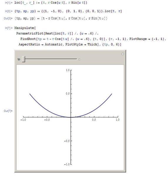

my_wan said:
Point it out to me
So, assume that we use the synchronization convention of post 105. Then the geometry of your tube changes as shown in the attachment.

  • #121
Basically implicit in that last post of yours is the claim that the geometry you chose to represent it is somehow the absolute geometry of the system. That's about as much abuse of the principles of relativity as can be dished out. No such geometric distortions is required for valid predictions.
