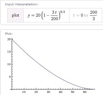

Using the given data for this problem:
$$C_I=0\,\frac{\text{g}}{\text{L}},\,R_I=16\, \frac{\text{L}}{\text{s}},\,R_O=40\, \frac{\text{L}}{\text{s}},\,V_0=1600\text{ L},\,y_0=0.0125\, \frac{\text{g}}{\text{L}}\cdot1600\text{ L}=20\text{ g}$$
we have:
$$y(t)=20\left(1-\frac{3}{200}t \right)^{\frac{5}{3}}$$
Here is a plot of the solution on the relevant domain $$0\le t\le\frac{200}{3}$$:
