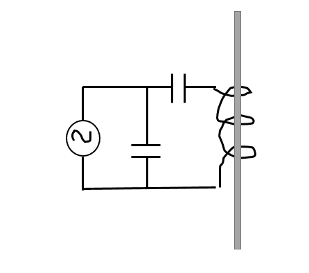

Hello all,
I'm playing around with a PIC + LCC Tank to send - at a 5MHz frecuency - some numeric data via BPSK. The receiver is a loop antenna placed in the ground.
The sender antena (L) is a ferrite core solenoid (N=10). As having a larger core, or increasing the Number of coils around the ferrite is having no much larger effect on the max. range which I can place the sender from the loop antenna (ground receiver)- what kind of amplificator can I use to increase the current in the coil an obtain a larger range?
The PIC I am using to send the instructions through the coil is a PIC16F.
Any worth reading reference that may cover this purpose?
Thanks in advance for your time.

Thanks for your help @berkeman :biggrin:
The project is a transponder - where the transponder (the coil element) send it's ID number, and the ground loop detects when has crossed the antenna.
Right now the max height that the transponder can be detected is around 60cm - but I'm a bit stuck with increasing that up to 1 meter.
This is just DIY project but of course trying to complain with CE regualtions.
Any ideas? Thanks!
Thanks for your help @anorlunda
It is quite similar to active-rfid/beacon (according to the blog description)
Until now, the info transmission and a basic design is working. I was just looking for a way to increase the range of the beacon/receiver max. separation.
As the PIC is the one sending the info via BPSK, I don't know if setting up some MOSFET between the PIC pins and the coil will affect in some way.
You do not need more transmit power. You need to improve the receiver gain.
What do you use now as the receiver ?
You must also study how the relative orientation of the antenna loops change with travel.

mehadao said:
Any ideas will be much appreacited
We don't really know how you are doing it, so it is a bit hard to guess where we can best help.
I doubt a PIC could generate more than 50 mW of RF from an IO pin, so I think it is worth looking at your experimental setup and seeing what can be done to increase the range, and maybe reduce the power needed by the PIC.
The more answers you give us, the more we can help.
What is the 5 MHz ? Is it a carrier frequency or is it the data rate ? We need to know both.
Are you directly driving a tuned LC transmit coil with a phase modulated square wave from a logic pin on a PIC16Fxx? If so, I would want to make sure the transmit antenna was wide band, and that the receive antenna was also sufficiently wide. For BPSK you will need to have a bandwidth of twice the data rate, centred on the carrier.
Have you simulated the circuits you have built with some version of Spice ?
Please post your transmit circuit, from the PIC to the TX loop. Also post the full circuit for the RX differential amplifier, including the bias circuit. You can attach the picture to a post.
The antennas will be important.
What is the diameter of the ground based RX coil? Does it have a vertical axis ?
What is the diameter of the vehicle based TX coil? Does it have a vertical axis ?
Does the vehicle travel outside the RX coil area, where the polarity of the carrier might fall to zero and then invert.
