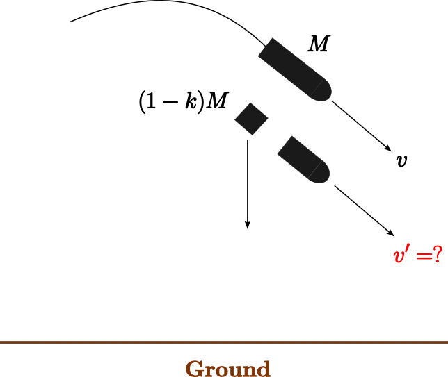

Consider a cannon shell of mass ##M## moves along a parabolic trajectory in the earths gravitational field. An internal explosion, generating an amount ##E## of mechanical energy, blows the shell into two parts. One part of mass ##kM## where ##k<1##, continues moving along the same trajectory with velocity ##v'## while the other part is reduced to rest. Find the velocity of the mass ##kM## immediately after the explosion.

I start by putting the image of the problem to the right.
A cannon of mass ##M## moving with a velocity (say) ##v##, splits into two parts of masses ##kM## and ##(1-k)M## following an explosion that generated an amount of energy ##E##. The second piece falls straight to the ground while the first piece of mass ##kM## continues in the same direction with a velocity ##v'##. What is the velocity ##{\color{red}{v' =?}}##

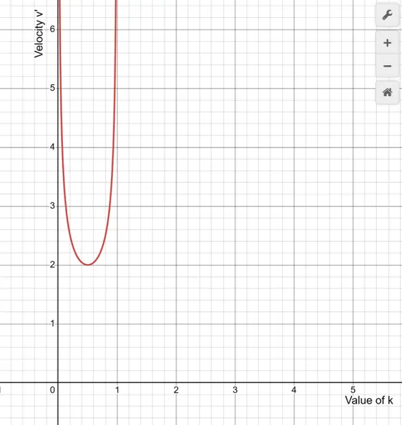

I plotted the solution for ##v'## in ##\verb|Desmos|## as given above, ##v'=\sqrt{\dfrac{2E}{k(1-k)M}}##, taking ##E=\dfrac{1}{2}## and ##M=1##. I copy and paste the image of the plot to the right. From the plot, as ##k\rightarrow 0##, the velocity ##v\rightarrow\infty##.

But the graph from the plot shows that ##v'## goes to ##\infty## as k goes to 1.
What is going on?
Request : The plot of the function is correct I suppose. I'd like a hint or clue as to where am I going wrong in my reasoning above for the case where ##k \approx 1##.
You are overlooking what E/M can be. As k gets closer to 1, less energy will be required to bring the fragment to rest, so E/M is tending to zero.
You mean the second fragment with mass ##(1-k)M##. Yes its mass tends to 0 as k approaches 1, but is ##E## the reason why its velocity after the explosion is 0?
Either way, even if it so, ##\dfrac{E}{M}\rightarrow 0## would imply ##v'\rightarrow 1## by my reasoning. But it is indefinitely huge as per the plot.

There's no contradiction if your model is also driving ##v## to infinity.
And indeed, you have ##v^2=\frac{2E}M\frac k{1-k}##, so it will.
