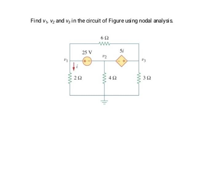

Find v1,v2,v3 using nodal analysis
"I in" ="I out" (KCL)
How does the current flow in this circuit and what is its actual true path, regardless of any directions in the figure?
What does the “5i” above the dependent source mean, and does the current flow according to the dependent source or the independent source?
Are the two resistors 2 ohms and 6 ohms connected in series or parallel?
I want to know more and more from the Veterans in electricity

The diamond
represents a dependent voltage source of ##5i## Volts, where ##i## is the current through the ##2\Omega## resistor (
in the diagram). Be sure to use the correct sign.

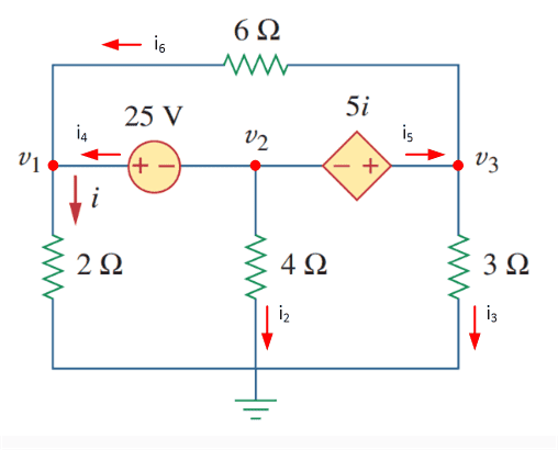

Perhaps it is useful to explicitly declare the three (!) currents at each node.
And 'node 2 has a dependent voltage source' makes no sense!
mkamalzayed said:
Explain more and more
It's all pretty basic: you have defined three nodes. At each node KCL says ##\sum i=0##.
If you followed my advice
you have something like the following diagram in front of you:
[edit] the current entering node 3 is named i5, not i4. Updated the image.
No worries about the directions of the currents: the correct sign will come out in the analysis.
The KCL for the three nodes give you three equations, Ohm's law four and the two sources two. Nine equations in nine unknowns. Straightforward math to find e.g. ##v_2## first, then ##v_1## and ##v_3##.

Which implies some KVL equations. Let's say a solution is defined by finding the 6 currents, then you only need 6 independent equations. These could be 3 KCL nodes and 3 KVL loops, with Ohm's law to connect them. I bet I could solve this with @BvU 's prescription. Except for the problem of being too busy, too lazy, and not really excited by the solution, whatever it is.
The two equations for the sources are ##v_1=v_2+25## V and ##v_3=v_2+5i## V.
In other words, i5 is not indpendent of i. Likewise, v2 is not independent of v1. These are constraint equations.
Since a network with 3 nodes like this would need at most 3 equations to solve it, given more than 3 equations they are not all independent.
This network needs only one KCL equation and two constraint equations. The 3 nodes can be treated as one supernode.
Note that the 6 ohm resistor does nothing. It can have any value, or it can be missing.
Also note that the problem statement requires a nodal solution.
Likes DaveE and BvU

Yes, it's a good observation. The zero impedance branches can effectively cut the network in two. Of course i6 does effect i4 and i5, but nothing else. So superposition let's you solve the lower loops separately, with 2 nodes and two loops.
KVL #1) ## 4i_2 - 2i + 25 = 0 ##
KVL #2) ## 3i_3 - 4i_2 +5i = 0 ##
KCL #1) ## i + i_2 + i_3 = 0 ##

v2 receives i2, i4, i5.
  • #33
mkamalzayed said:
Where????
These currents flows out of v2
Look at the diagram in post #15. i2, i4 and i5 are shown.

You are forgetting what BvU said in post #15: "No worries about the directions of the currents: the correct sign will come out in the analysis."
The arrows on the diagram may not be showing the direction of physical current flow. What if i2 has a negative value?
