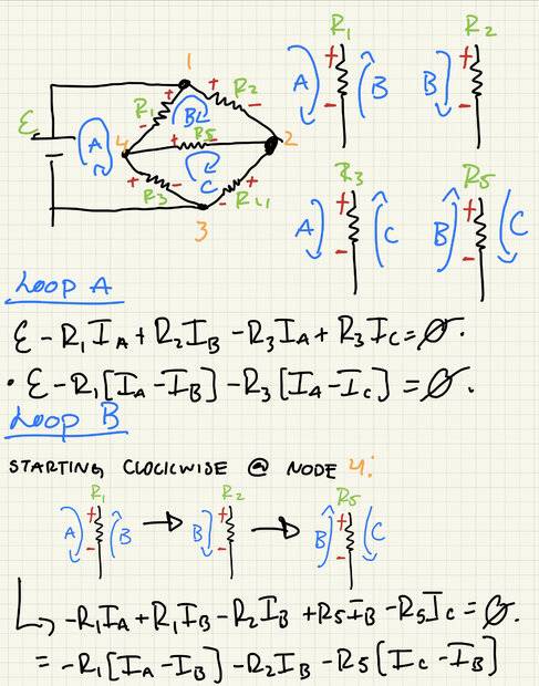

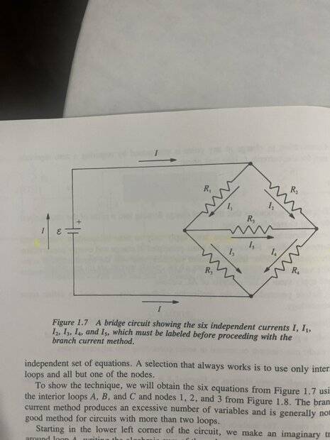

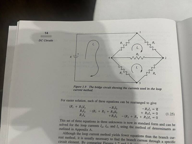

Attached is the example I am working out of a textbook that involves using the Loop Current Method on a bridge circuit. In the pictures attached I am following section 1.6.2 which produces loop equations (1.24) for figure 1.9. Figure 1.7 provides the direction of current.
I am having trouble producing the same result as the book I am using for Loop B and C.
Following Loop A, we travel up the EMF,
##\varepsilon##, and then we reach ##R_1##. At this resistor, ##I_a## travels down the resistor and ##I_b## travels up it. Likewise, at ##R_3## ##I_a## travels down the resistor and ##I_c## travels up it. Traveling down the resistor leads to a drop in voltage which leads to a negative sign in associated with that voltage.
Following this logic, I receive the same equation for Loop A as seen in equation 1.24.
So now when evaluating Loop B, I will begin at Node 4. Again, at ##R_1## ##I_a## travels down the resistor and ##I_b## travels up it. This produces ##R_1I_b-R_1I_a##. Next we go down resistor ##R_2## and get ##-R_2I_b##. Finally we have resistor ##R_5##. ##I_b## travels up and ##I_c## travels down this resistor, giving ##R_5I_b-R_5I_c##. Simplifying this and setting it equal to zero gives:
$$-R_1[I_a-I_b]-R_2I_b-R_5[I_c-I_b]=0$$.
So my logic works for Loop A but for Loop B, this logic produces the opposite of what the book gives for the resistors that contain a superposition of current.
Could someone help me understand how I am approaching this wrong?
I'm not following your steps there. The references to up/down and the relationship to the signs are unclear.
Going clockwise around the loop, ##I_b## always has the same sign. You have
##R_1I_b-R_1I_a##, ##R_2I_b##, ##R_5I_b-R_5I_c##
So I disagree with your sign for ##R_2I_b##.

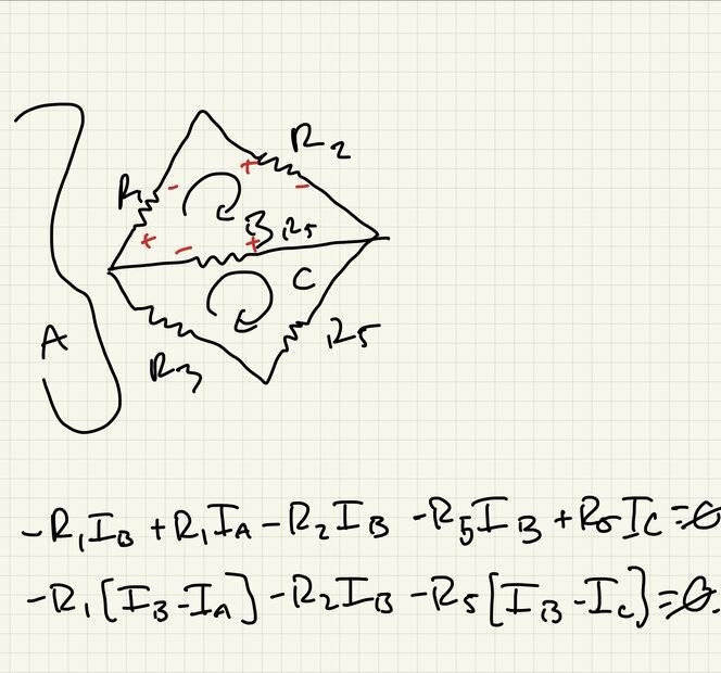

Hopefully this makes my thought process clear. I tried breaking down how I viewed each resistor when traveling loop B.
I am finding that I only get the same result as the book when I assign the voltage drop polarity with respect to the loop I am following.
So when I follow Loop A clockwise, I get the assigned voltage polarity as seen in my previous post.
But when I start at node 4, and follow loop B and treat it as the direction current is traveling, this switches the polarity of ##R_1## and ##R_5## and gives me the same result as the book (1.24).
Could this be the problem I am encountering? It seems as thought voltage drop polarity with the "Loop Current Method" is dependent on the direction of the loop.EDIT:
This may seem convoluted but I think this explanation makes sense. Given the name of the method "Loop Current" I think its treating the direction of each respective loop as the current. So you have to determine the voltage drop polarity for each individual loop.
Yes, that's how I believe it works.
