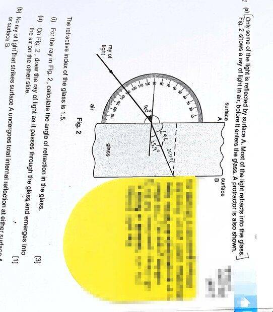

qn: explain why a ray of light that enters the glass through surface A cannot be totally internally reflected at surface B.
n = sin I / sin r
the angle of incidence at A is 40°, then why did the answer key say "angle of incidence at A is just less than 90°". it is obvious that 40° is quite far from 90° right?

Hi, and
:welcome: !​
Breaks my neck to look at your picture :mad:
Yes, that is obvious. But to get a possible total internal refection at B, you need a maximum angle of refraction, and therefore a maximum angle of incidence. So they observe ( correctly :smile: !) that for a maximum angle of incidence at A

just to clarify, is it maximum angle of refraction and incidence at B ?
Can you think of a way to get a bigger angle of incidence at B ?
