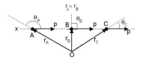

From the link I gave, you see the following diagram (which I slightly modified)
This shows a particle moving with constant speed along a straight line. Note how θ is indicated for the three positions A, B, and C. Hopefully, that agrees with your understanding of θ. Using trig, can you relate rA, θA, and rB. Note rB is the perpendicular distance from the origin O to the line of travel of the particle.
sin(180-θA) = RB / RA
OK. Can you simplify sin(180-θA) using a trig identity? Then solve your equation for RB in terms of RA and sin θA.
(Note, there is a formatting toolbar that you can use for subscripts, etc.)
RB = sin(θA) * RA
Good. So, how can you express the angular momentum of the particle at point A in terms of RB?
L = P * RB
Yes. Note that RB is the perpendicular distance from the origin to the line along which the particle is traveling. So, you can see now that no matter where the particle is along the line, the angular momentum may be calculated using L = R##_\perp## p.
What is the value of R##_\perp## in your problem?
is it 10cm?
No. Draw a line representing the line along which the bullet is moving. You can extend that line as far as you like. R##_{\perp}## is the shortest distance from the origin (center of disk) to this line. See RB in the previously posted figure.
