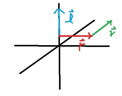

2. Shouldn't this be zero? If you evaluate r x V using the right hand rule, the vector points up, so the angular momentum is solely in the z-plane, right?

2. If you evaluate r x V using the right hand rule, the vector points up, ...
Did you draw a diagram showing the vector r and the velocity vector V?
I made a quick drawing on paint:
Is this reasoning right?

You want to find the angular momentum about the origin (of the coordinate system). So, where should vector r start from?
Completely slipped my mind that it's the frictional force doing the deceleration. I get the right answer that way. Thanks!
Oops, the vector r points from the origin to (0.5,0.75,0). Then to find the component of the angular momentum in the xy plane, I'll need to use the vertical component of vector r. That yields 9 using L=mvr.

Yes, I think this is correct for the magnitude of the total angular momentum vector.
Now, I don't seem to calculate the right component in the z-direction though for the angular momentum...(this is a separate question)
I did:
[ (0.5, 0.75, 0)m x (0, 6, 0) m/s ](2 kg) and I get 9 kgm^2/s
You have 0.75 as the y-component of the position vector. I don't think that's correct.
