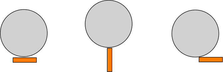

A disk [m=0.1 Kg; R=0.1 m] rotates about its center of mass [w=40 rad/s], on a smooth floor. A bar [m=0.1 Kg; lenght=R=0.1 m] moves on the floor with a speed Vb=4 m/s. At one point, the bar hits disk's edge in an inelastic collision, and they start rotating together.
A)[Fixed axis passing through disk's center of mass and perperdicular to the floor]
-Find the new angular speed [w'] of the system disk+bar]
B)[System can translate after the collsion]
-Find the new angular speed [w''] of the system disk+bar];
-Find the CM's speed

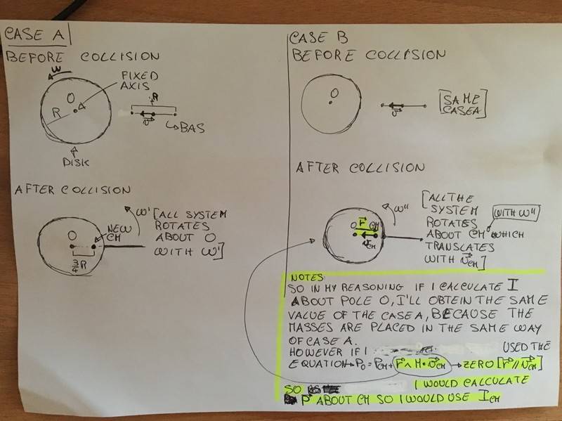

A)
When the bar hits disk's edge, same forces on the axis through the disk's CM prevent the system start rotating about the new CM. The momentum of these forces is zero because they have the same direction of the vector r, so the angular momentum (P) is costant:
[I choose disk's CM as pole for the momentum, so I'll calculate the moment of inertia from that pole]
-P1=I1*w1=1/2*m*R^2*w1
-P2=I2*w2=(I(disk)+I(bar))*w2=(1/2*m*R^2+1/12*m*R^2+m*(R+1/2R)^2)w2=17/6*m*R^2*w2
-P1=P2
- 1/2*m*R^2*w1=17/6*m*R^2*w2--------->w2=0.5*w1*6/17--->w2=0.5*40*6/17=7.06 rad/s
[Right solution]
B) In this case the rotation axis isn't fixed so, after the collision, the system starts translating and rotating about the new CM. Also, since the axis is not fixed, there are no external forces, so the traslational momentum [Q] is costant.New CM's coordinates:
-DISK:
SUM(m(i)*x(i)^2)/m=0------>SUM(m(i)*x(i)^2)=0
-BAR:
SUM(m(i)*x(i)^2)/m=3/2*R------>SUM(m(i)*x(i)^2)=3/2*R*m
-DISK+BAR
Xcm=SUM(m(i)*x(i)^2)/2m=(0+3/2*R*m)/2m=3/4*R
[Ycm=0]
CM=(3/4*R;0);
CM's speed
Q=costant
Qi=m*Vb
Qf=Mcm*Vcm=2*m*Vcm
Qi=Qf
m*Vb=2*m*Vcm---->Vcm=Vb/2---->Vcm=2m/s [Right solution]
Angular speed of the system (w'')
Initially I thought that w'' was the same of w', which I found in the previous point.
Also in this case the momentum of external forces is zero [there are no external forces bisides weight, actually] so P is costant. If I choose the same pole for the angular momentum I find the previous equation. However book's solution is different, since it calculate the angular momentum about the CM.
I tryed to motivate this solution in this way: in general, the angular momentum about a generic pole O (in this case disk's CM) can be written and the sum of two terms: the angular momentum about the CM's of the system and the term r^(M*Vcm) wher Vcm is the CM's speed aboout the pole O. So:
Po=Pcm+r^(M*Vcm)
In this case r parallel to Vcm so that r^(M*Vcm)=0 and Po=Pcm
My finally question:
In point A, I tried to calcute P using Po=Pcm+r^(M*Vcm), and I found the same result of calculating the moment of inertia about the disk's CM and using P=I*w both before and after the collision.
In point B P=I*w can be used only before the collision.
So, I don't understand why it can't be used also after the collision and why in the case A
Po=Pcm+r^(M*Vcm) and Po=Io*w provides the same result, so when I can use both of theme
Is there a diagram? I can interpret that description in a number of ways. Was the bar moving parallel to its own length or transversely? If the second, what part of the bar hit the disk? Did it strike the disk full on or tangentially?...
The information you provide is incomplete. It is important to know the relative velocity between the bar and the disk's edge and how the bar sticks to the disk. See below for just some possibilities that affect the system's new CM and moment of inertia.

I think I would need a diagram. It is important where the bar’s initial vector points relative to the disks rotation axis, and also I cannot tell the orientation of the bar after the collision. In fact it is difficult to determine the shape of the bar from this post much less how it sticks to the disk

Sorry guys and thanks a lot for the help. I tried to explain it in the text but I haven't been clear enough. The new system is the second one (the system in the middle).
But which way was the bar moving?

And is the bar’s velocity vector pointed directly at the disk’s axis? Also is there any more information regarding the shape of the bar? You can assume it is thin compared to R and the shape won’t matter much. However the post wasn’t clear.
So in this problem you need to conserve angular momentum and linear momentum. Case a is easiest. The fixed axle ( force of constraint). means you only need to conserve angular momentum. The axle also gives you no choice what point to use as an axis.
Sorry but I don't speak english very well, so I have some difficulties to explain the problem. The bar is unidimensional (length) and, yes, the velocity vector is pointed directly at the disk's axis.

When I calculate w'' (which is the angular speed in the case B), initially I tried to use the axis of disk's CM, using the equation P=I*w.
Before the collision the bar has not angular momentum about the chosen pole because its speed is pointed directly to the axis, while the disk rotates with anguar speed w=40 rad/s. So Pi=I(system)*w=(Idisk+Ibar)*w=Idisk*w+Ibar*w. The term Ibar*w is zero beacuse the bar doesn't rotate so Pi=Idisk*w=1/2*m*R^2*w-------->Pi=0.5*0.1*0.1^2*40=0.02 m*kg*m/s [same result of case A]
Afet the collision the disk and the bar rotate together with the same angular speed w''. So Pf=(Idisk+Ibar)*w''
Idisk=1/2*m*R^2
Ibas=1/12*m*R^2+m*(R+R/2)^2=7/3*m*R^2
Pf=(1/2*m*R^2+7/3*m*R^2)*w''=17/6*m*R^2*w'' [same result of case A]
Pi=Pf------>1/2*m*R^2*w=17/6*m*R^2*w''------------->w''=0.5*6/17*w''-------->w''=0.5*6/17*40=7.06 rad/s [same result of A, but wrong solution]
**In case B- before collision the disk rotate with w
In case (b), after the collision the final angular momentum is ##L_{final}=I_{cm}\omega_{final}##, where ##I_{cm}## is the moment of inertia about the two-body system's center of mass. I trust you can find ##I_{cm}.## At this point you have to be careful. The angular momentum just before the collision must also be calculated about the point where the CM is located just after the collision, not about the center of the disk.
On edit: If you choose to calculate the angular momentum about the center of the disk, you have to be consistent and include the angular momentum of the CM about the center of the disk in the expression for the final angular momentum. You cannot use the center of the disk for the initial angular momentum and the center of the mass for the final angular momentum.

Yes, In fact I applied Huygens-Steiner theroem to calculate the moment of inetia from the disk’s CM and so the angular momentum.
Indeed I don’t know how I can calculate the angular momentum about the disk’s CM calculating the momentum about the CM of the system before the collision and then add the momentum of the system’s CM beacuse I should obtein the same result but I don’t understand how.
However I think this is not the error of my resolution which, I repeat, it’s right but I don’t understand why one method doesn’t work
