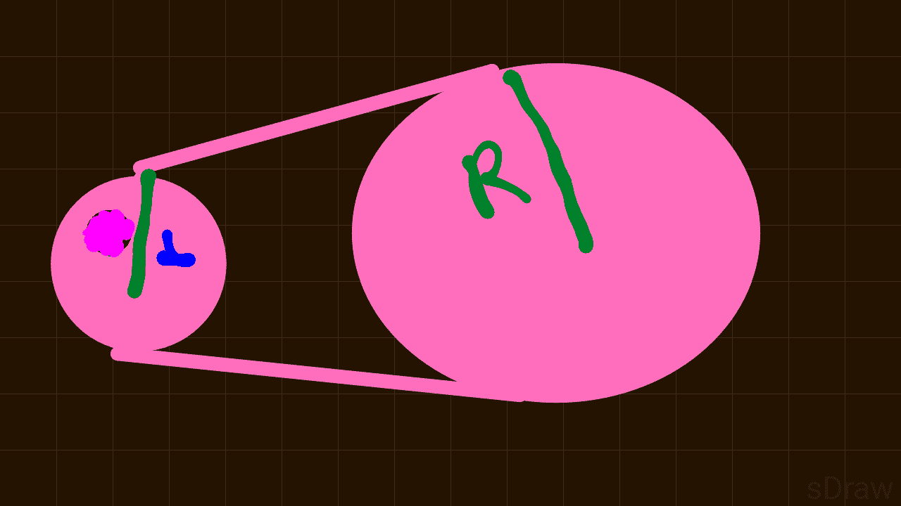

Let r = radius
See picture.
If r = 6 cm, R = 10 cm, and the angular speed of the larger wheel is 100 rpm, determine the angular speed of the smaller wheel in radians per minute.
Again, 1 revolution = 2 pi radians.
I need to use w = θ/t.
So, θ = 100 rpm • 2 pi radians.
θ = 200 pi radians
w = 200 pi radians/min, which is my answer.
At this point, I doubted that my answer is right because it did not take long to find w or omega representing the angular speed.
The book's answer is 1000/3 radians/min.
What did I forget to do?
$v = r \omega_1$, where $\omega_1$ is the angular speed of the smaller wheel
$v = R \omega_2$, where $\omega_2$ is the angular speed of the larger wheel.
the belt connecting the two wheels has a fixed linear speed, $v$ ...
$\implies r \omega_1 = R \omega_2$
$\omega_1 = \dfrac{R \omega_2}{r} = \dfrac{10 \cdot 100}{6} = \dfrac{500}{3} \, rpm$
convert $\omega_1$ to radians per minute ...
$\dfrac{500 \, rev}{3 \, min} \cdot \dfrac{2\pi \, rad}{rev} = \dfrac{1000\pi}{3} \, rad/min$
Nicely-done. I will try your solution steps for this question to answer the textbook question where r = 6 cm and R = 10 cm.
