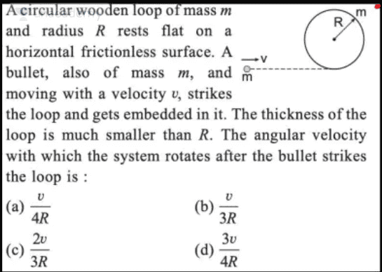

A circular hoop of mass m and radius R rests flat on a horizontal frictionless surface. A bullet, also of mass m and moving with velocity v, strikes the hoop and gets embedded in it. The thickness of the hoop is much smaller than R. The angular velocity with which the system rotates after the bullet strikes the hoop is:
Conservation of Angular Momentum
Parallel axis theorem to find Moment of Inertia
First off, I do know how to solve this problem. We use the principle of conservation of angular momentum about the centre of mass of the system which comprises of the loop and the bullet to obtain option B. My doubt is, why do we just not use the principle about the centre of the loop? Where is the problem in that?

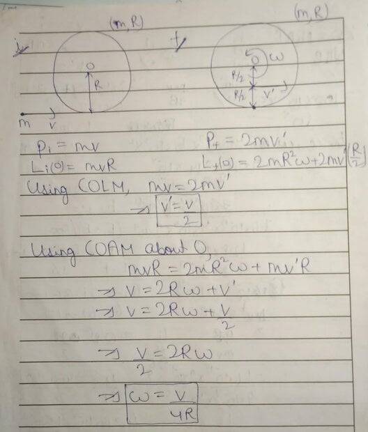

Ok, so here it is.
We conserve angular momentum about the centre of mass of the loop, since all forces are internal, there are no external torques and hence this principle can be applied. The point where the bullet strikes the loop lies at a distance R from our reference point.
Initial angular momentum is given as ##MvR##. ie. before the bullet strikes the loop.
The moment of inertia of the system about the same point is given as ##mR^2 + mR^2 = 2mR^2##.
So, final angular momentum is given as ##mR^2 ω##.
Equating the two, we get ##ω## as ##ω = \frac v {2R}##.
Which does not match the actual answer of ##ω = \frac v {3R}##.
By the way, I have posted my approach in which I have a doubt, and not the correct one, I will post it if it is needed.
What point are you taking as your reference for the angular momentum calculation?
Is that point moving?
To be clear, you can do the analysis about any reference you choose. That reference can be in any state of motion that you choose. But you need to choose. And you need to make that choice clear so that we can follow along and understand your work.
It appears that you have chosen the initial position of the center of mass of the loop as your reference and chosen a standard of rest in which the loop begins stationary.

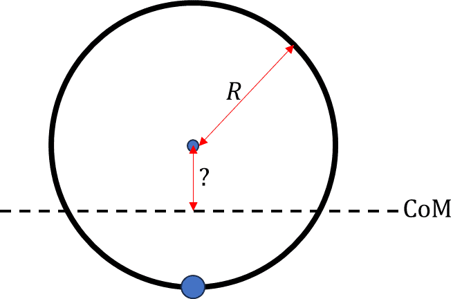

It's most concise to work around the combined systems center of mass as the reference for conservation of angular momentum here. The center of mass of the thin ring (alone - without the embedded bullet) is not the axis of rotation of the system after impact.
erobz said:
The center of mass of the thin ring (alone) is not the axis of rotation of the system after impact.
How do we show this? And, can we use the same reference point and still get the correct answer? I have probably missed a few terms.

The center of mass of the system is where the instant of impact? The masses of the bullet ##m## and the ring ##m##.

brochesspro said:
We conserve angular momentum about the centre of mass of the loop, since all forces are internal, there are no external torques and hence this principle can be applied. This centre of mass lies at a distance R from the centre between the centre of the loop and the point where the bullet strikes the loop.
Your language here is extremely ambiguous.
The center of mass of the loop is some distance away from the center of mass of the loop? That distance is the same as the radius of the loop? I find it basically impossible to parse what you want to say.
brochesspro said:
Initial angular momentum is given as MvR. ie. before the bullet strikes the loop.
Now you are using R as the orthogonal distance from the center of the loop to where the bullet hits. This is compatible with using the center of the loop but not the center of mass of the system as the reference.
If you are not using the com as the reference, then you are missing terms due to the linear momentum of the system.

I'm asking you to use the system center of mass as the reference.

Why does the bullet initially have an R value? assuming that mvr=(12/4mr^2)ω
  • #31
Do you mean, why does it have initial angular momentum mvR?
  • #32
Elj said:
Yes why does the bullet initially have angular momentum, if it is traveling linearly
Anything moving linearly on a path offset from the reference point has angular momentum.
Elj said:
assuming it is a point mass with some radius r,
This is nonsense. A point mass is a point and has no radius.
Elj said:
why does it cancel out with the radius of the loop
It … doesn’t?
  • #33
Orodruin said:
Anything moving linearly on a path offset from the reference point has angular momentum.This is nonsense. A point mass is a point and has no radius.It … doesn’t?
alright then can you explain how to solve it, Im genuinely confused
  • #34
I already did. See #22 and #23.
  • #35
Using conservation of angular momentum about the centre of mass, which is ##\frac R 2## below the centre of the hoop:
$$L = mv\frac R 2 = m(\frac R 2)^2 \omega + I \omega = (\frac{mR^2}{4} + I)\omega$$Where ##I## is the moment of inertia of the hoop about the centre of mass of the system. Using the parallel axis theorem we have:
$$I = mR^2 + m(\frac R 2)^2 = \frac{5mR^2}{4}$$This gives:
$$\frac{6mR^2}{4}\omega = mv\frac R 2$$$$\omega = \frac{v}{3R}$$
