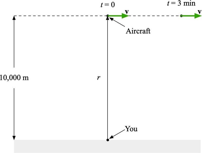

An aircraft passes directly over you with a speed of 900 km/h at an altitude of 10,000 m. What is the angular velocity of the aircraft (relative to you) when directly overhead? Three minutes later?

Well, that's a place to start. Can you identify any of the quantities given in the problem statement with the variables in that expression?
From the eqn v=rw, only the value of v=900km/hr is given the question. Is the altitude considered as radius?
In that equation, ##r## represents the distance from the point of reference to the moving object. What do you think? Does the altitude fit the bill?
I think so but I am not sure
Making a drawing can help.
What do you think now?

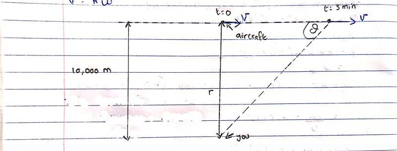

Try drawing a triangle where the angle ##\theta## subtends the horizontal distance traveled by the plane in time ##t##. What is the rate of change of that angle w.r.t. time?
Is the drawing right?
I would define as ##\theta## the other acute angle. See post #12. This problem is a one-liner if you answer my question in #12.
I had the other angle in mind ( as @kuruman suggested). We should probably ask (based on what @jbriggs444 noted) are you supposed to be using calculus to solve the problem?
For the case when ##t=3~\rm min##, the distance ##r## between you and the aircraft is the length of the hypotenuse. Note that you can't simply set ##v=900~\rm km/h## because ##v## in ##v=\omega r## is the magnitude of ##\vec v_\perp##, the component of the velocity perpendicular to ##\vec r##. That's what @jbriggs444 is getting at in post 13.
The other approach to solving the problem is to forgo using ##v=\omega r## and use ##\omega = d\theta/dt## instead, where ##\theta## is the angle described by the others. You want to express the angle as a function of time and then differentiate.
I would suggest you solve the problem both ways. You should get the same answer either way.
