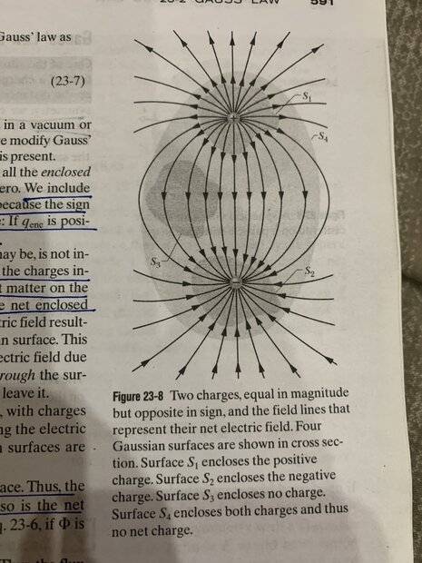

Let me provide you one reference where we can discuss on common ground. Now focus on surface S1. We place a Q near S1. It will bend its line of forces. There is new field.
you are saying either we take flux x-y+y=x all individual fluxes or flux of resultant field which will be x. Charge outside has no effect on the flux of resultant field. It will be x no matter what charge is outside.
  • #54
Yes this is all about what we 've been talking about for so many posts. The flux through the surface S1, seems that it must be different since we have now bended lines of force, however it isn't different because that's what Gauss's law tell us, that the flux depends only on the enclosed charge, it does not depend if the field lines are bended, or there is some external charge that bends the field lines , or if the resultant field changes or e.t.c

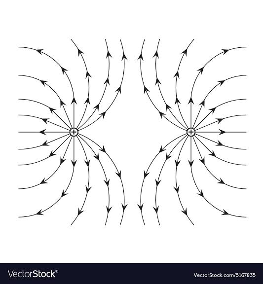

Here in this figure I can see there are two types of lines. One from one charge and another from other charge. If I take one charge away then the field lines will straighten up. There is no resultant field of lines. We only see resultant‘s effect when we place a test charge. That is what I was trying to say before. There are two constituent fields bent like that but no third resultant field.
  • #73
No I insist those field lines are the field lines of the resultant field.
