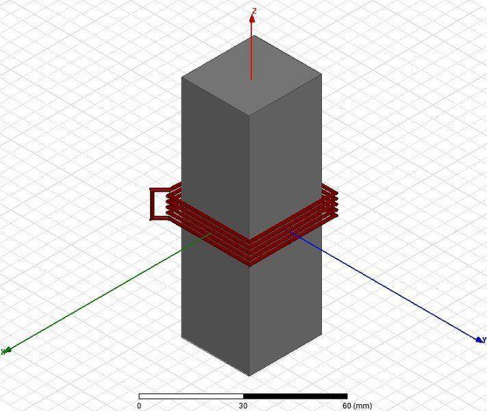

Maxwell: Terminal surface mesh does not fit with conduction path in th
Hi guys,
I run a simulation on Maxwell and got the following warning.
Terminal surface mesh does not fit with conduction path in the following bodies {Coil}. Please verify them to ensure no bad effect on solutions! "
I could not identify how to fix the problem. chenging mesh size didn't help me.
Thanks in advance for your help !
  • #75
Simplify this coil (no rounding). In addition, check if your "region" around model does not touch any element besides coil terminals (coil terminals must lay on "region" box plane).

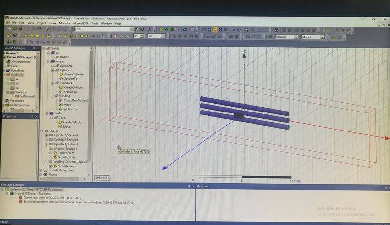

Here is the screenshot of error i am having. I know that reason for leakage is coil and excessive region for coil. What can i do to eliminate this current leak? Kindly help regarding this as i am stuck with this for a week. Thank you
  • #94
You're right. The problem is caused by too large "region". Reduce it's size so your excitation would be on the face of "region".
In your case delete the "region", create a new one with option to "pad individual directions". Then input the parameters but remember that in X direction (-X and +X) it should be 0. In Y and Z input percentages you think will create the region big enough to cover all phenomena you'd like to simulate. Alternatively this can be done via components tree - just open the create region command there and input parameters as mentioned above.
  • #95
Region is being made according to cylinders i have made. And for coil this region is too big. For my project, i cannot make large coil so i have to stick with this. Is there any other alternative. I just did what you said. Thanks for reply
  • #96
You can modify the size of "region" the way I just mentioned. Adjust it's size. Does this fix your problem ?
  • #97
Nope, actually when I set region to 25 or 50 or 100.it is adjusted according to cylinders. 0 means attached to cylinders but still big for coil.
  • #98
Oh, so the cylinders are not your coil. Okay. So, where's the coil ? cant's see it.
  • #99
Coil is in front, it is helical one wounded on ferrite cylinderical core. 3 large cylinders are acting as transmission lines. And region is being made according to large cylinders
  • #100
So you need to adjust your geometry, there's no other way.
